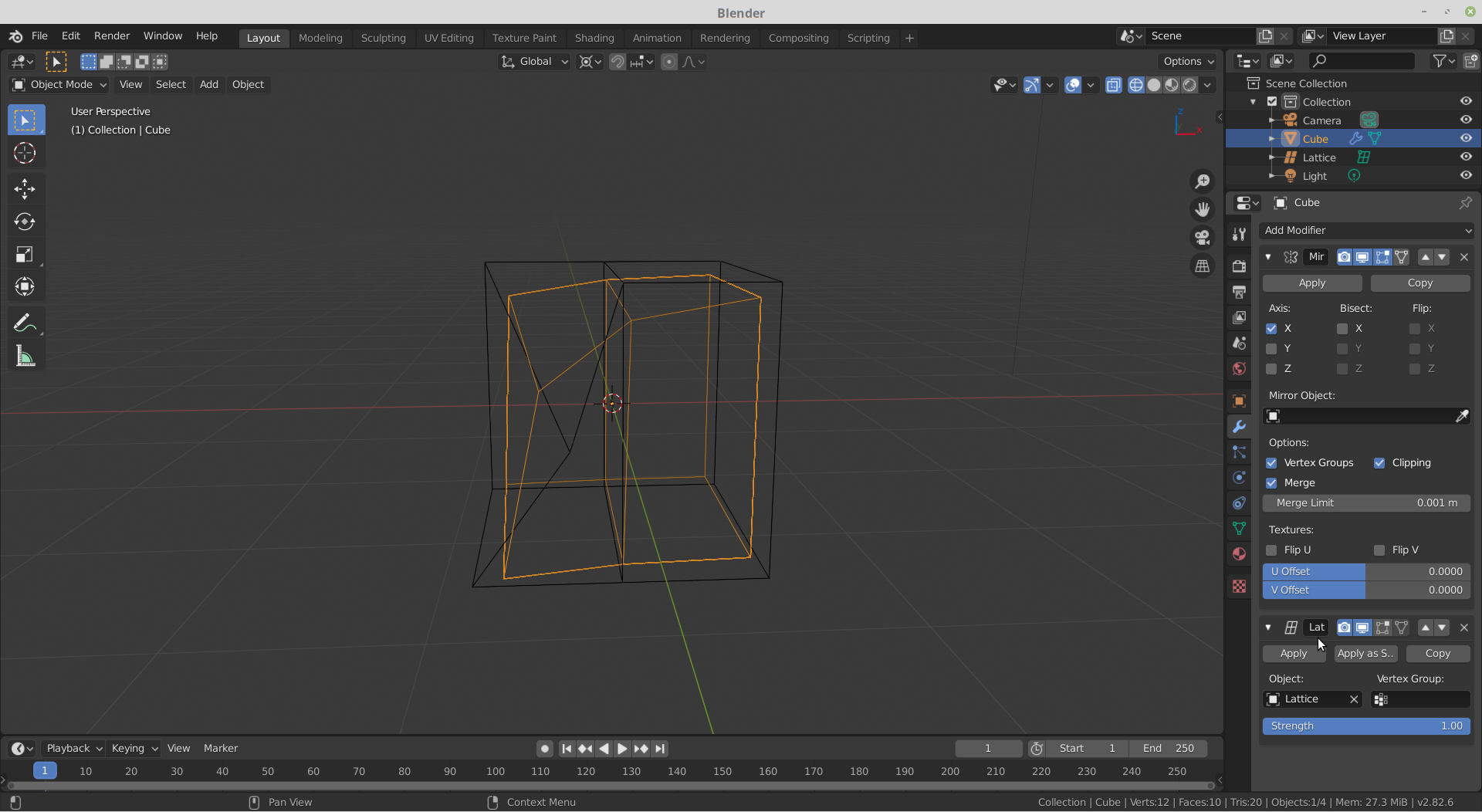

          You can also use any Deform Modifier after the Mirror Modifier to destroy the symmetry undestructively; for instance a Lattice:
          But in this case, with the lock bracket, I would apply the Mirror Modifier, like Wayne said.
