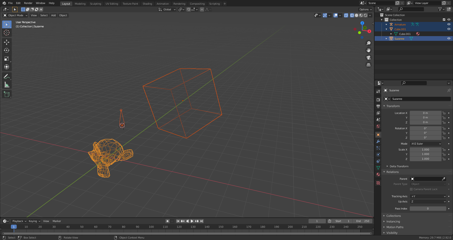

      Take a scene with 3 objects: 1 armature (translated), 1 cube (translated, rotated and scaled) and Suzanne (not transformed:

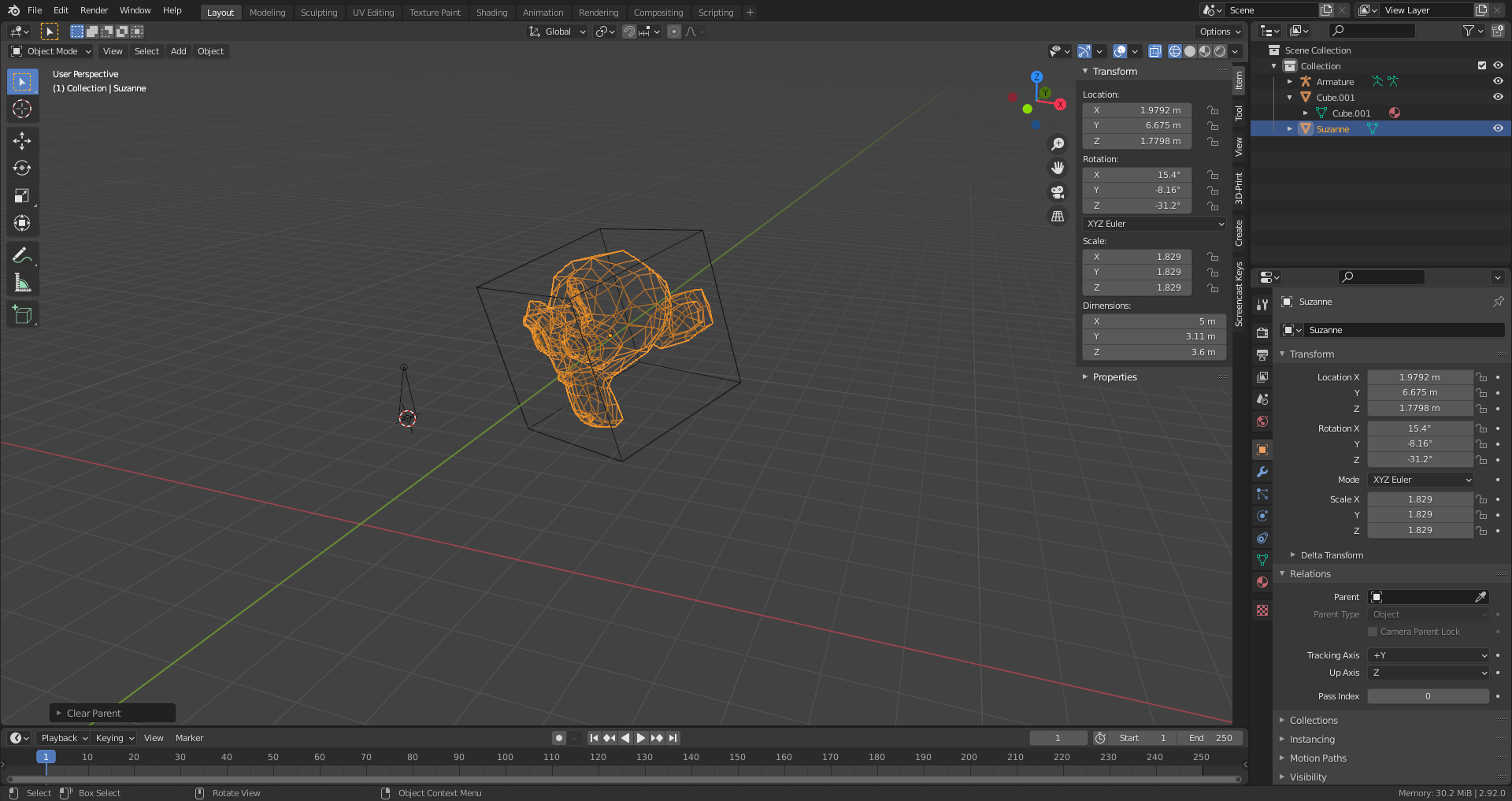

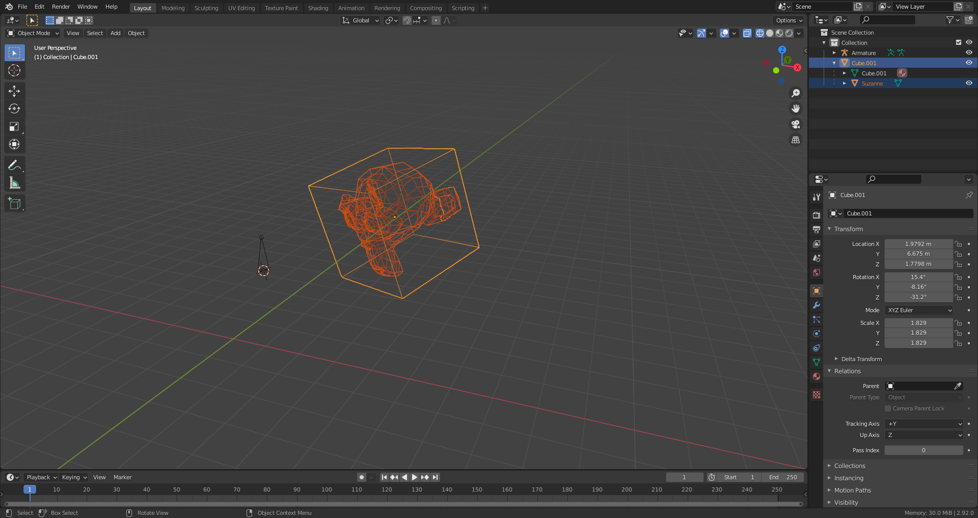

      1) Parent Suzanne “without Inverse” to the cube so that it gets perfectly aligned within the cube:

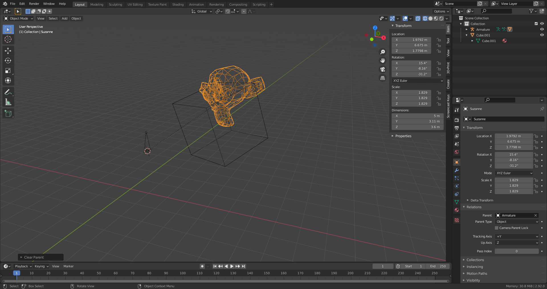

      2) Clear Suzanne’s parenting with “Clear and Keep Transformation”:

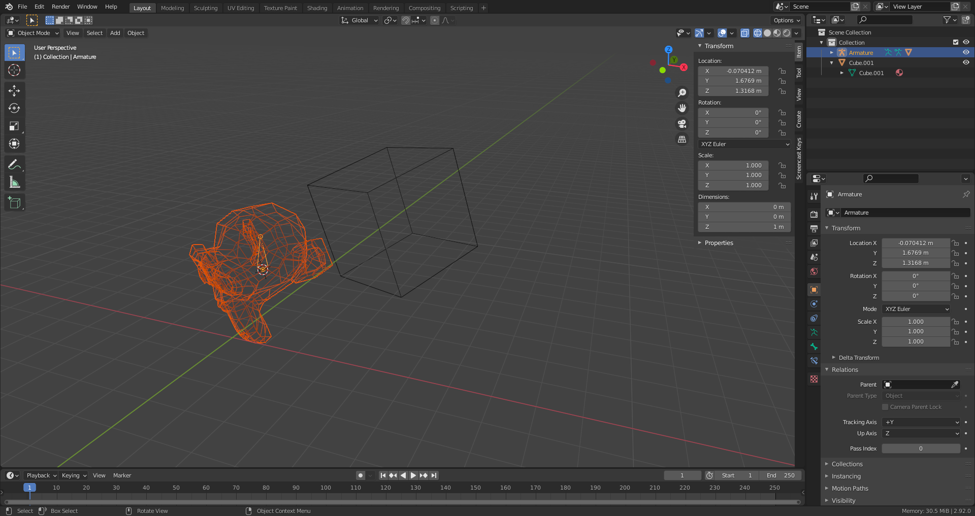

      3) Now parent Suzanne to the armature with “Object without Inverse”. Suzanne snaps to the armature as expected:
