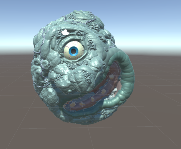

        Yes, that’s what I have been using. the projects I have been uploading to the gallery have been from medium except for GG. I have imported the textures separately into unity, and it still seems to break up and look bad. here is a pic of what importing to Unity does to the textures:

          Even if it feels like sculpting with foam, Medium is a pretty revolutionary sculpting program. The problem is that it has to unwrap the textures automatically, and it does that by creating 30 or so individual “islands”. All those individual patches of texture needs to be aligned perfectly. If you started animating the model, those patches would likely mess up even more.
          The chinks on the edge of the box shape is caused by Medium creating the box out of lotsa triangles. Medium is really bad at exporting hard shapes. Natural soft shapes do much better.
          Personally, I still consider using Medium for the raw sculpting, simply because it is way fun! But I will clean its retropology in Blender, and also colorize it there, and generate new normal maps.

                I imported it into Unity and it worked fine. The only minor issue was that it created one material, so I had to create a separate material manually to add in the eye textures. Here is what it looks like in Unity:

                  Amazing! I thought there would be more problems than that. On the other hand, when I tried toying with it in Blenders Sculpt Mode, the mesh started comming apart, so I guess it would need some clean-up first.
                  #31243
                  Jonathan Gonzalez
                    I never used it in Blender myself so I’m not aware of the topology. It did seem very dense though, the model was split up since it exceeded the vertices allowed per single mesh object. I’ve never used Medium, but I assume it’s essentially all sculpted models? I don’t think that would be ideal for game asset use unless they were properly retopologized. Maybe as high end models it might be fine. Probably starting off in Medium then cleanup in Blender would be best.
