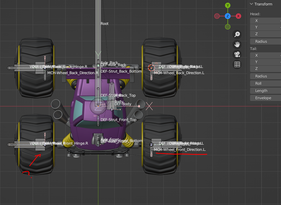

      Hi, this is a weird one.
      When I symmetrize the wheel bones from L to R everything works except the MCH-Wheel_Front_Direction.L bone.
      I’ve gone over it several times and made sure to select ALL the bones but it keeps doing the same thing.
      I think I might have the naming wrong but it looks correct to me.
      It works fine on the rear wheel.
      Any ideas as to why??
      Thank you!
      #74758
        Hi James @Smartassmusic ,
        You are probably right, that it’s because of the naming; if I see it correctly, you have a dot at the end (after the .L): …Front_Direction.L.
        #74759
        James Treweek
          Crikey! You’ve got good eyesight!
          YES!
          Thank you SOOO much. I’m loving frying my brain with this software but it’s invaluable having the input of experts when I (inevitably) crash and stop for some reason.
          #74760
          Wayne Dixon
            Hi James,
            Don’t worry this happens to me all the time.  And every time it’s because there is a “.L.”
            That dot is so hard to see after an L!
            #74761
            James Treweek
              Ha, ha! Thank yes,  it IS difficult to see isn’t it.
              Oh well, now I know, I look out for it 🙂
