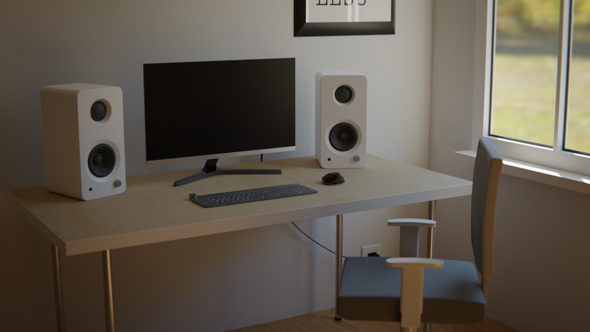

        Hi Jonathan! I made this scene a couple months ago. I was going for a minimalist desk setup that looked photo-real. Though I am not disappointed with the outcome, it didn’t exactly come out how I had imagined. Do you believe the materials are to blame for the “non-photo-realistic” nature of the image, and if so, how could I go about improving it?
        Thank you!

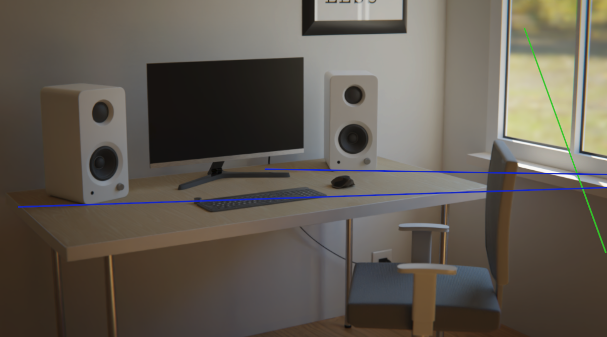

          One thing that makes this look wrong is the fact that the shadows are not consistent….where is the light coming from?
          Also, I might be mistaken, but it looks to me as if there is a ‘flat’ image behind the window, instead of a HDRI…

              Hey @hashtag02 , that looks like a great scene to experiment with on the stream! There are a lot of good things to say about it and I agree that it is just short of photo real. May I poke around the file? You can pack the textures and post it to pasteall.org , Dropbox, or something and link it here.

                @spikeyxxx There are two light sources in the scene: the HDRi (it’s not a flat image) set to a strength of 1, and a sun lamp shining into the window.
