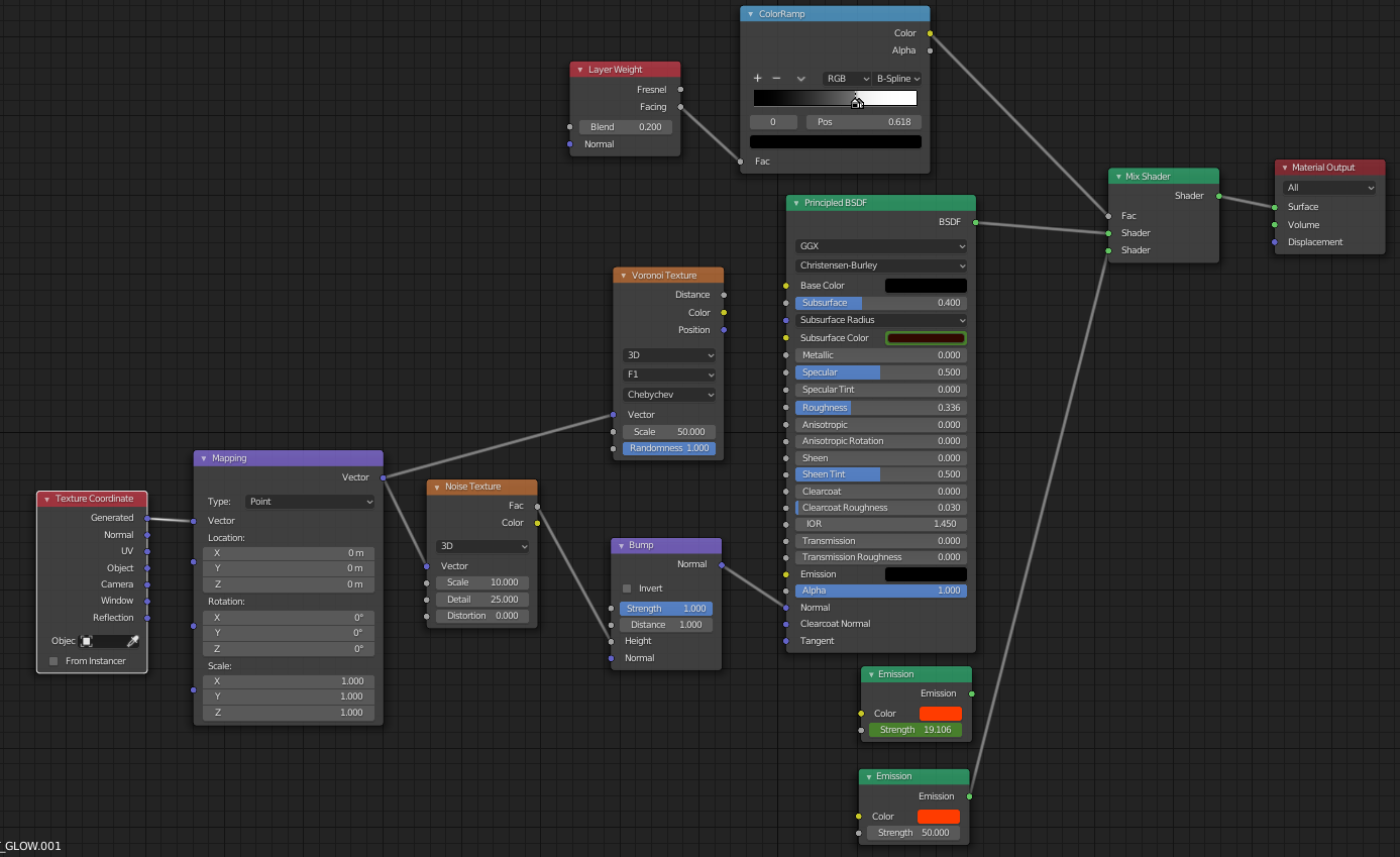

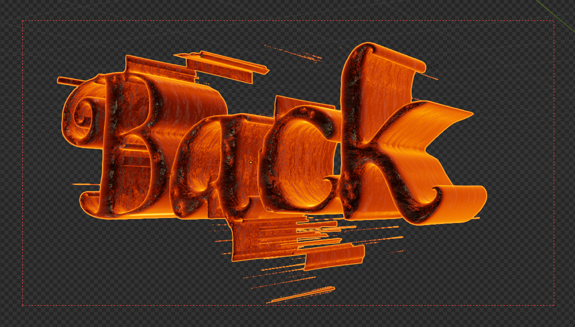

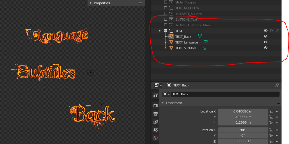

      Can anybody figure out why this mesh text shows fine in viewport render , both from camera view and in 3d space as shown below , but when I render it out is is invisible… The material setup is also shown below. As you can see , nothing is set to indirect or mask or anything in the outliner so I am stumped. Most likely something silly….
      RENDER PREVIEW FROM CAMERA VIEW :
      RENDER PREVIEW IN 3D VIEWPORT
      MATERIAL NODE SETUP:

        Did you make it non-renderable in the outliner?
        #57407
          Like @williamatics already said, that is the only thing I can think of:
          #57408

            @williamatics , @spikeyxxx  , wow yeah… I am dumb ,  as I said in my post , it would be something silly…… I was just so frustrated at it that I didn’t even think. Strange thing is , I ran this render fine yesterday but today I tweaked a few things in the material and re-rendered and that’s when the issue arose , but in that time I had no reason to disable the render and don’t remember doing so…..
            Thanks guys!

              @frikkr Maybe you accidentally disabled it from your Object Properties tab instead, since you’re on that tab in the screenshot? In the visibility section of that tab, you can disable in viewports, renders and selectable.

                Ahh , I did not know about that , thanks!
