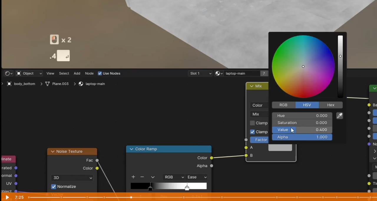

            Hey Chris,
            I think you got your Color in slot A  of your Mix Color Node too close to white. Kent uses a Value of 0.4 there:

              chris depew
                That was it! thanks. mine was at 4.0 my dyslexia saw .4 tho lol. Thank you!
