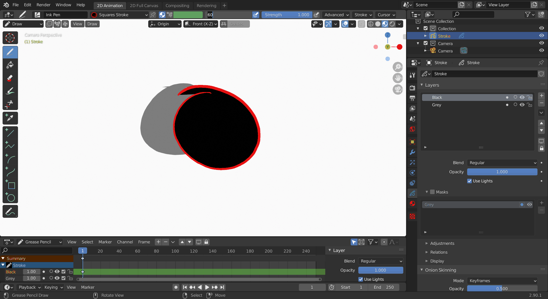

      I am following directions, but the shading layer is not making when I click on the masking button (formerly called clamping?). Any ideas?

        Yes it seems that the masking setup is a little different these days.
        First you need to enable that masking button (previously called clamping)
        Then you need to specify which layer you want to be the mask under the “Masks” tab.  (and you can invert it in that tab)
        Check out the wiki page here.
        https://docs.blender.org/manual/en/latest/grease_pencil/properties/masks.html

          Thanks, Wayne. That works! Any idea when we will start seeing some 2.9 courses on animation?
