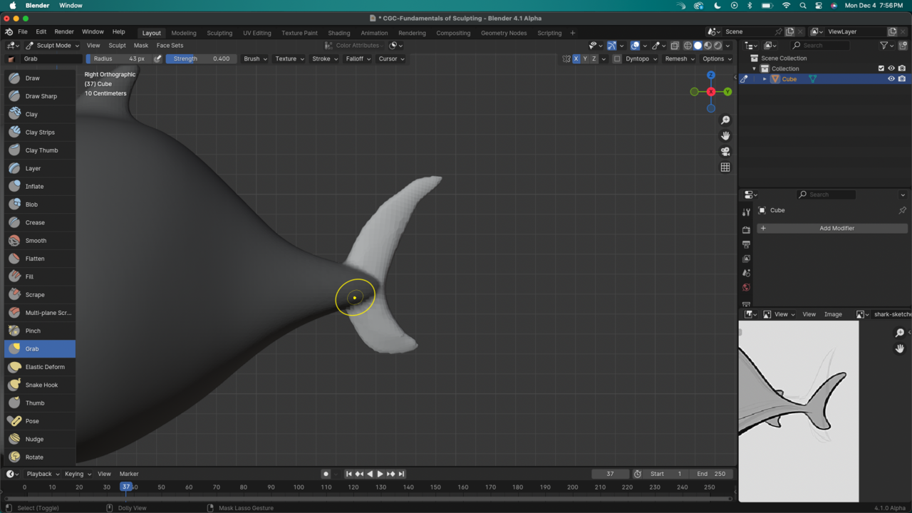

        I tried smoothing out the bumps on the edges of these fins, but it ends up drastically changing the overall shape. Sharing an image just in case it’s the size of the brush (at this point I was holding shift – smooth at 0.35 strength on its own if that makes a difference)

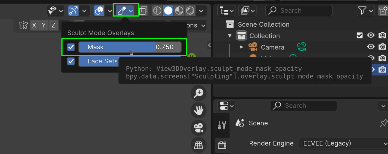

          You can make the Mask darker, by changing the Overlay to 1:
          And the effect of the Smooth Brush depends on the Mesh Density, as well as on the Brush Strength. Also, if you use the SHIFT shortcut, the Smoothing uses the Strength of the Brush you are using at that moment, not the Strength of the Smooth Brush.

            Awesome, thank you! The mask overlay being full dark makes it so much easier to see where it starts and where it ends.

                  For the mask, as in the post above by Martin, you only need to set the overlay to 1, which will set the mask to full opacity. But then for the following alongside with Kent, that is a bit tricky, since sculpting is a lot like drawing, in that you may think you’re doing the same as what you see on screen, but there’s the art part that can’t be copied like that. It’s as watching someone hand draw a super realistic portrait, even if you follow along, you wont be able to paint the realistic portrait as he is doing, because that person knows how to make realistic portraits, he’s had years and years of practice and experience. Same with Kent, he makes it look easy, but he knows how to sculpt, and we just can’t copy his skills just by watching, we need to practice a lot before we get that good.
