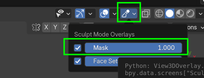

        Hi Jonatan @JonatanLyssens ,
        You can set the Mask Overlay to 1 to make it black (the default is 0.75):
        The other issue could have something to do with the resolution of the Mesh. (It might also already improve, by having the Mask Overlay completely black…)
        #90401
        Jonatan Lyssens
          Thank you. That did the trick.
