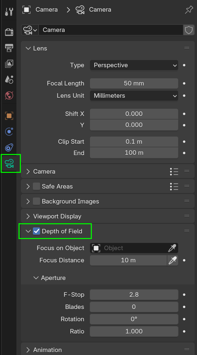

        Hi Sid,
        Blender has got you covered:
