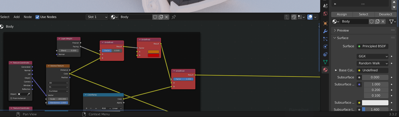

            This appears to have been made in 3.4, as it uses a Node that doesn’t exist in 3.3 yet (at least not in this form):
            In 3.3:
            maybe that causes the crash?
            The Mesh has one misplaced Vertex and a few holes; nothing that would cause Blender to crash in my opinion.
