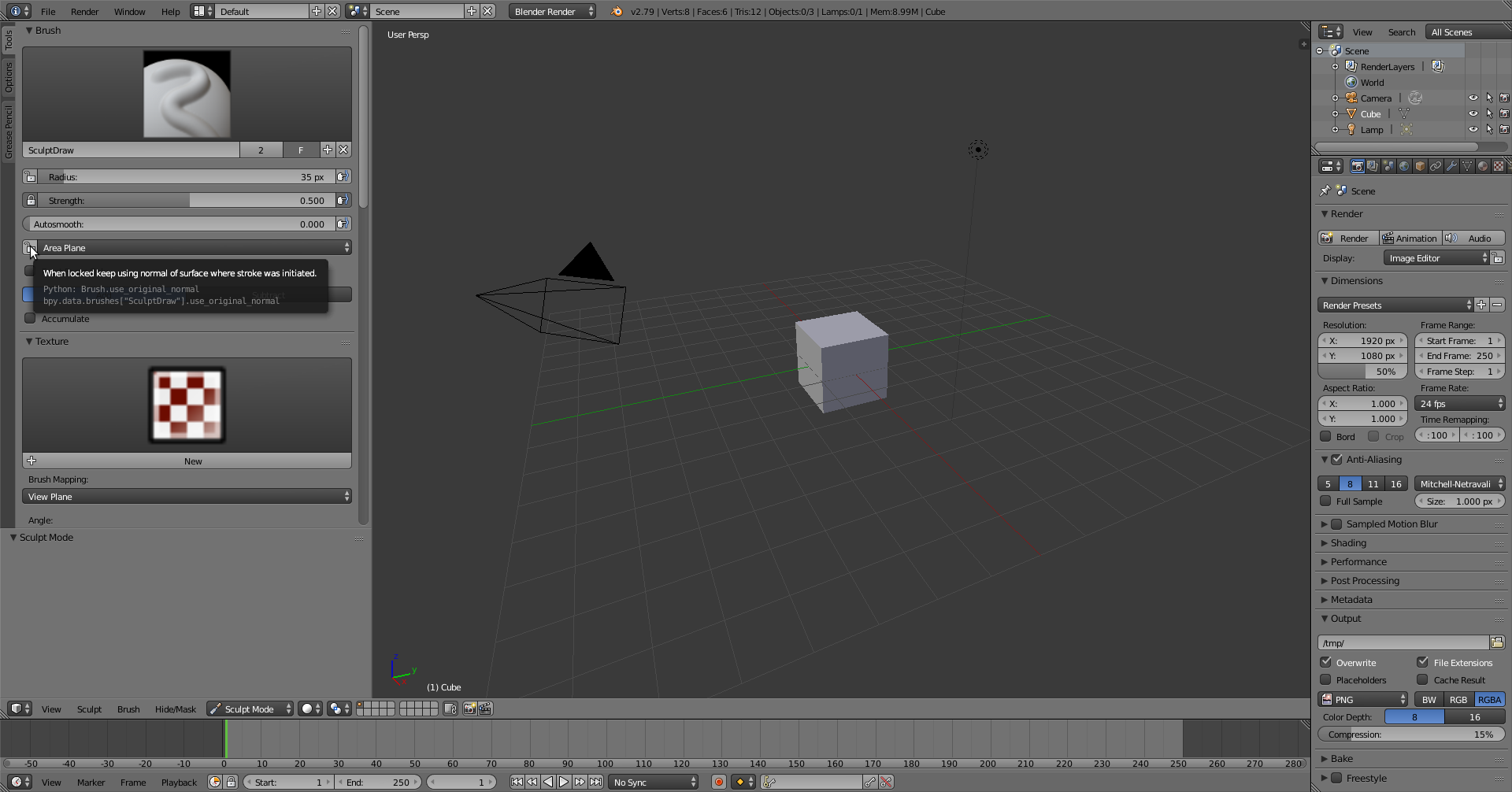

      I’m wondering where I can lock the “Sculpt Plane” in Blender 2.9x as you did it here in Blender 2.76:

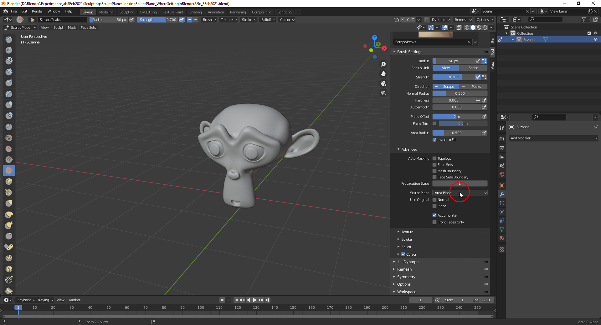

      Blender 2.92 Alpha:
      How does it work?

        Could I say that the “Locking” in Blender 2.76 takes a “Sample” of the “Topology” under the “Brush” at the beginning of the “Stroke” and used these “Parameters” for the whole “Stroke” instead of continuously resampling the “Topology” for each “Brush (Movement) Step” ?

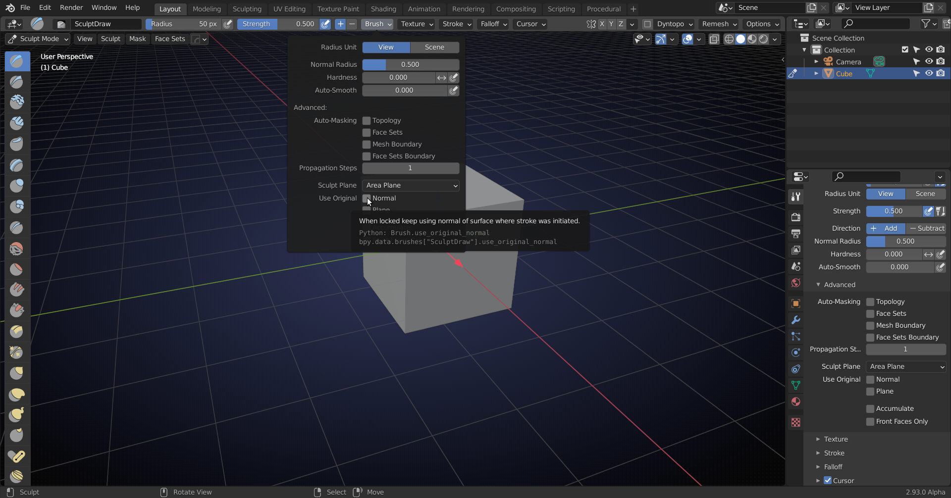

        There seems to be a “Locking” as the “Quick Tip” for “Use Original Normal” suggests:
        But the “When locked …” of that “Quick Tip” also suggests in my opinion that the “Locking” has to be set elsewhere.

          Using Original Normal (that is: checking the box) does the same as locking the Area Plane in 2.7.
          Same Tooltip and same Python code.
          It seems that they changed the UI, but kept the old Tooltip, which makes it hard to understand that Tooltip 😉
          Someone should change that (sounds like an easy thing to do).
