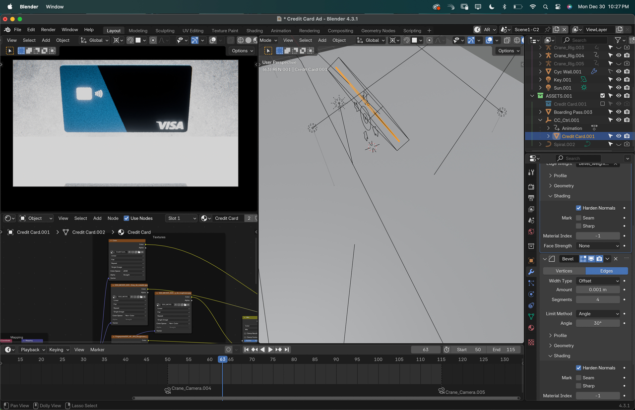

      I’m making a super simple scene where this card flips in the air. Lighting looks great except for a few frames where this super hard shadow goes through.

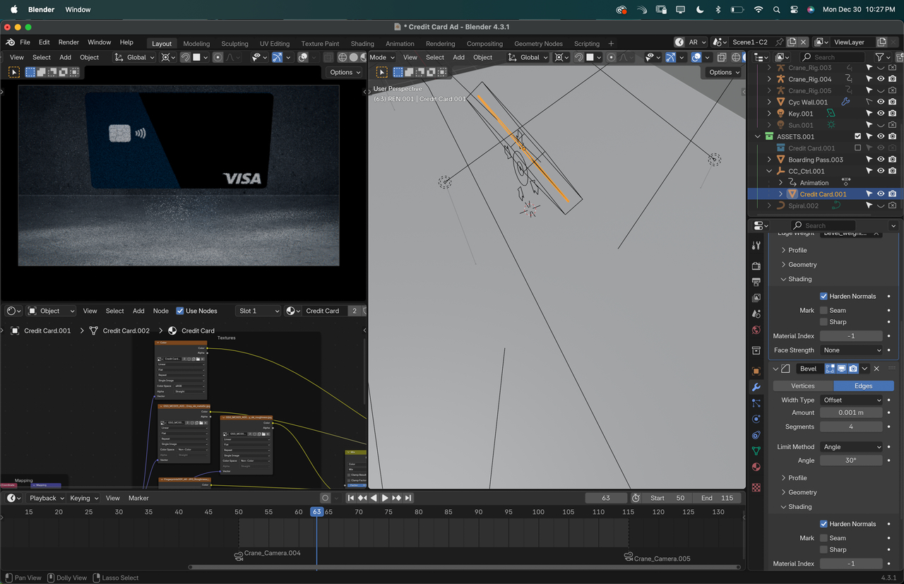

      At first I imagined it was the flip… it must be facing the ground or something. Well..not entiretly. So I tried a bounce card. Heck, not even a sun lamp right in front of it will light it. 🤔

      Must be the geometry, UV map? But wouldn’t it show on the remaining of the scene? The card/textures are fine at all other times.

          Perhaps the card is too thin and the geometry is freaking out. Try making the card a bit thicker and see if that makes it go away.
          #92411
          Nathi Tappan
            That was a great idea Omar, one that I haven’t thought about troubleshooting at first, but was totally feasible especially because I modeled the card to real life dimensions and it is tiny!
            But after going through my textures and turning on an off every single node I found a problem with a color ramp on my normal map. I cannot explain why at all… but for some reason having it set to B-Spline caused the weird dark line. Ease, Linear, or off… and no problem at all.
