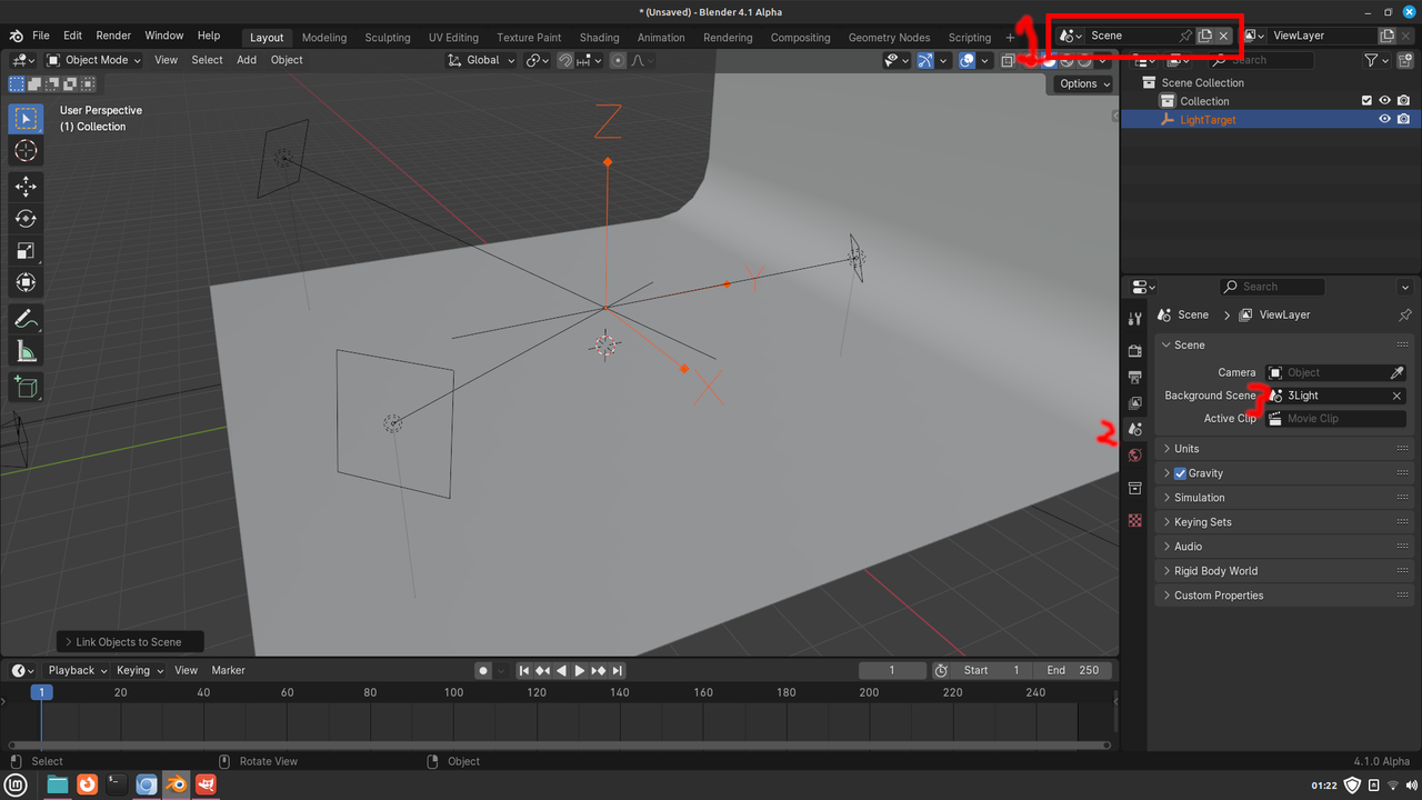

              Let me note that I add objects like infinity screen, light box mesh, a camera set to photographer’s height, etc. I also have an empty that I have all the lights point to. To do this add the empty, select the light, add a track to constraint on constraints tab of the properties editor, set constraint’s object to the empty.
              The setup is easy. Setup your default lighting. Then in scene controller Number 1 in the image below. Change the scene name to your light setup name. For example: 3Light. Then save your blend file.
              1. In a new blend file, append the scene:File->Append or F4->Append. Browse to the blend file. double click it, then double click the scene folder, and select your scene. Click append at bottom of file browser.
              2. In scene tab of properties editor(#2 in image) on the scene panel set your light scene to the background scene(#3 on Image). Note: If you have a camera setup in this scene then set the camera to the camera in your light scene.
              You can make changes to the lights(Camera) through the light’s scene which you can switch by clicking icon to left of the scene name in the scene controller(#1 in image)

                If you use the empty to focus the lights like I do you can link it to your scene to make it so you can move it around in your scene. You can also link the camera if you want to have control of it in your scene. Select your light scene
                Then select the empty(Or any objects you want to link to your scene). Then press ctrl+L->Link Objects to scene->Your scene name. Default is Scene.
                Then switch back to your scene you now can work with the empty(Or the objects you linked) in your scene.

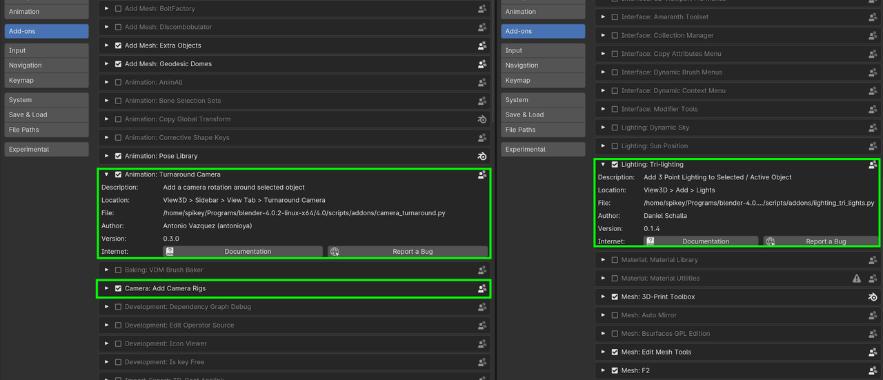

                      Yes, if you have animations like on the camera it will be appended as well. If you’re just doing a turnaround animations and a simple 3 point light setup you may want to just enable the addons Tri-Lighting(Under lighting category) and Turnaround Camera(Under animation category). Then save any screen or light box meshes as assets. Tri-Lighting is easy. You select the object that you want the lights to focus on then press shift+a->Lights->Tri-lighting I think or maby 3 point lights. Sorry don’t remember of the top of my head. Then use the adjust last operator(expand the setting box in left hand corner of 3D viewport or press F9 to bring it to the mouse cursor) to adjust the lights strength, angle and size. Note:This is where I got the idea of setting a track to constraint. I think it still does that. Then with the focus object still selected do the turnaround camera. Open N-panel(Technically called the sidebar. Hotkey is N). on Animation tab there is a turnaround camera panel. Expand, then set your setting and click turnaround camera button. I remember that the button was in a weird place at the top it looks like it a label but it’s a button. Also if they haven’t changed it, the x, y, and z settings are not degrees of rotation, but the number of rotation that happen in the frame range you set. There are other options as well. Side note:These are are things that I used more in a TD role. The animators/modelers would do any clean up or changes as needed. So I don’t really know how useful they would be in a solo workflow.
                      #83141
                        Also, Nathalia, have a look at the Addons that come with Blender:
                        #83142
                          Oops, Dwayne beat me to it..
                          #83143
                          Dwayne Savage
                            Good call @spikeyxxx I forgot about camera Rigs addon.
