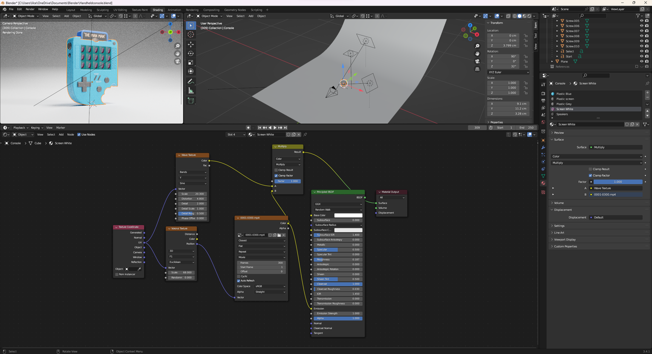

Hey, if you check the node graph, you’ll see the output is actually connected to the Multiply node, which is outputting a straight color. Most likely from previewing it with Node Wrangler. Connect the Principled BSDF instead and you’ll be good to go!
