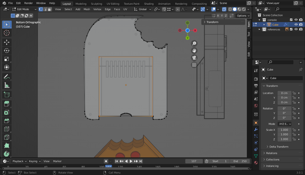

      Got away for a few and now with a fresh set of eyes getting back into the Beginners Course! Issue is I’m trying to make the cartridge insert part and having a hard time cutting so I can bring down the box for the insertion. Attached a pic for yall to view. Its suppose to look like a rectangle but the back cuts are not working. Any suggestions please?
      Thank ya 🙂

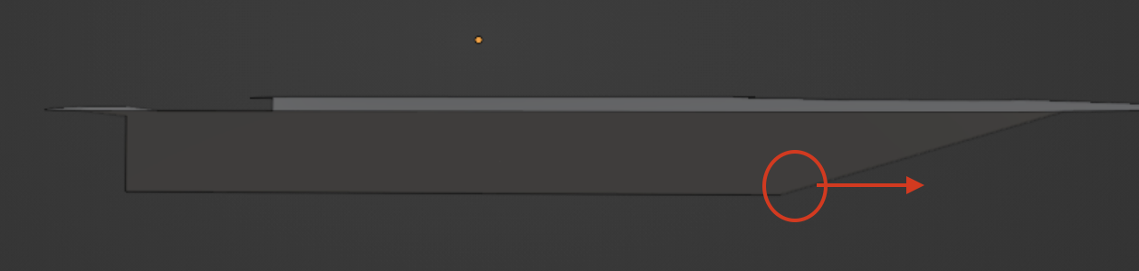

        Hmm, I don’t understand much where the issue is. Maybe you can post other pictures detailing the problem further.
        In the mean time, if I understood correctly, looks like you could move this vertex to make the shape more square:

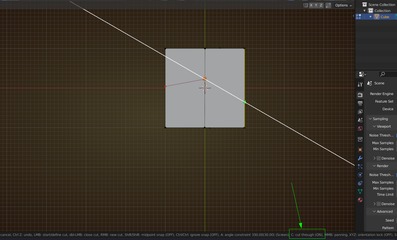

            When using the Knife tool, pay attention to all the options at the bottom of the Viewport. The most important ones are A (angle constraint) and C (cut through). These are both off by default. You probably need to enable Cut Through:

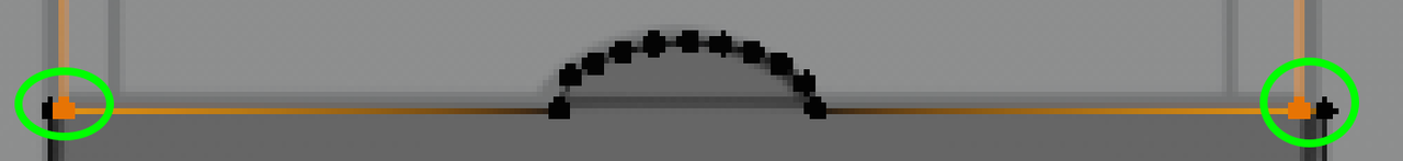

                  I watched the video and there is no need for the cut through, the cut is only made in the bottom plate.; the top is even hidden, to not clutter the view.
                  On your screenshot the cut looks pretty close, just Merge those corners to the unselected Vertices:

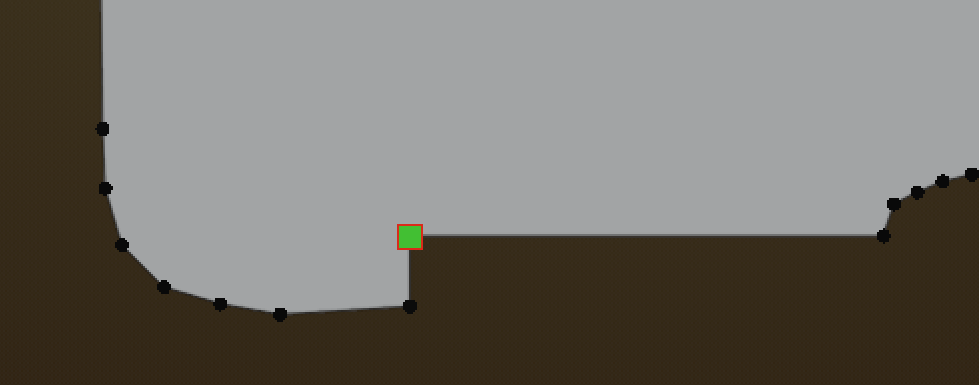

                  If the Knife is on top of an existing Vertex, it gets a red outline like this:
                  Then you don’t need to Merge afterwards. But both ways are valid; if I have made a cut and ‘missed’ a Vertex somewhere, I usually just Merge instead of re-doing the cut (several times).
