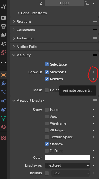

        You can do that in the data properties on the right under visibility, think it’s just above Viewport visibility. Not at computer right now, but sure it’s there. Different ray visbilities too, all easy to keyframe.

          And as Dwayne says, the little dots let you keyframe:

            How do you set the keyframe on the icon though? I tried a few different modifier keys but it just toggles on or off.
            In the Data properties it’s easy, but the ability to do it straight on the outliner is much faster!
