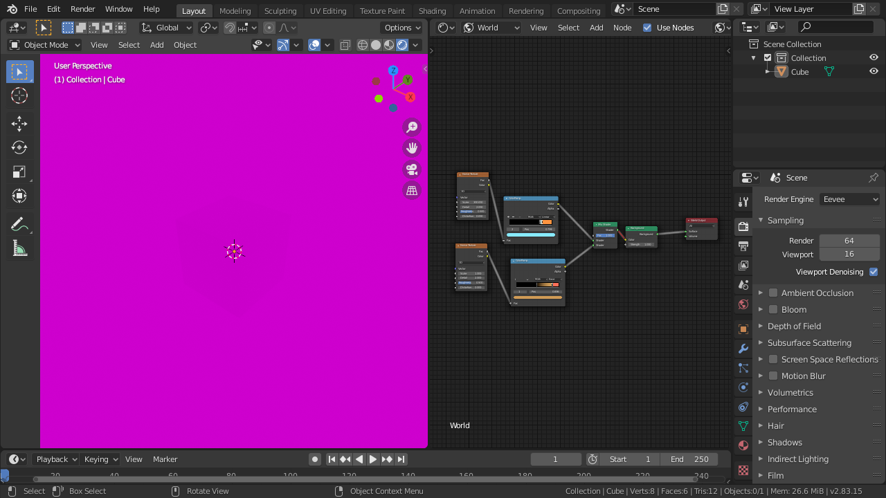

      Why when I connect the mix shader to the background it Turns pink. What is the reason?
      Here is the node!👇🏼
      #58385
        Hi shanr, you are using a Mix Shader instead of a Color > Mix RGB Node! (You can see a red line where you connect the output of the Mix Shader to the Color input of the Background Shader, indicating that the connection is wrong!)

          Yup. Use Mix RGB instead and it should work better.

            The naming of these two nodes is a bit inconvenient, I think…It took me a few years before I understood the difference and when to use which, (This was before the different types of Nodes had different colors; all the Nodes where grey, which made it a lot less obvious…I can’t even look at that any more.)
            A Mix Shader is not just a ‘Shader that mixes’, but it mixes Shaders. In the same way: a Mix RGB, mixes (RGB) colors.
            I like to think of them as ‘Shader Mixer’ and ‘RGB Mixer’…
            Also an Add Shader is not just a ‘Shader that adds’, but it adds Shaders together, so more of a ‘Shader Adder”…

              It Worked!
