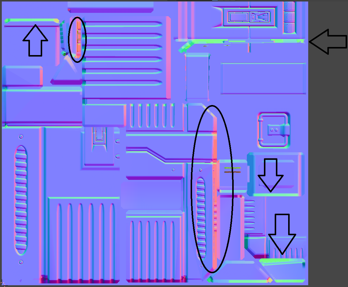

      Hello, for some reason some parts of the map are always extreme green or extreme red, even if i used a cage like its described in the video that totally envelops the low poly. Here is  the blend file.
      Any ideas?
      #68477
      Jonathan Lampel
        Hey ryn, it looks like this is happening because the low poly edges are too far away from the high poly edges. If you imagine shooting a ray from the side of the low poly from the cage object, you can see how it would miss the high poly object entirely. This sort of thing would work for an organic shape that is smooth shaded because then the ray would be angled inwards towards the edge as the normal gets blended, but for hard surface objects where the rays will always fire perpendicular from the face, this will cause problems.
