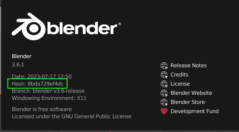

        You could also post a screenshot of the information screen with the hash:
        (This is from 3.6.1 and the Linux version, so yours will be different)

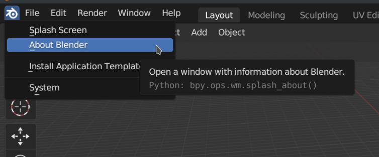

        You can get that by clicking on the About Blender:

          And btw, Berkely is an official Mirror:
