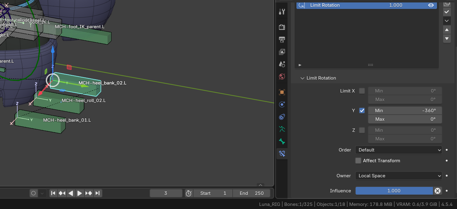

      I’ve run into a problem with the rig: the “Foot Heel” mechanism isn’t working.
      All parent relationships and constraints are set correctly.
      However, in Blender 4.5, the “Limit Rotation” constraint no longer has the “Legacy Behavior” option.
      As a test, I opened the same rig in Blender 3.6, and everything worked correctly there.
      Could you please help me understand what might be causing this issue in Blender 4.5?

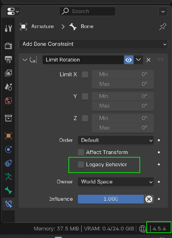

        HI Arthur @Devarth ,
        When you say:   “… in Blender 4.5, the “Limit Rotation” constraint no longer has the “Legacy Behavior” option.”
        What do you mean by that?

          I don’t have the “Legacy Behavior” option in the Limit Rotation constraint. My Blender version is 4.5.4.

            Hi Arthur,
            Are you using an Addon (or a Script)?
            If you Open a new File, is the Legacy Behavior available?
            #97989
            Arthur S
              Yes, I disabled the rigging add-ons and restarted the program. Everything worked—thank you! I’ll continue with my training calmly.

                        Hi Katherine @katriliza ,
                        “Since the Legacy Behavior option was removed”
                        Just to be clear, that was not removed; the option is still there, even in 5.1.
                        It was an Addon that caused the issue.
