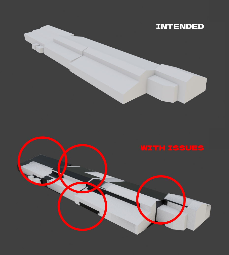

      I have a simple model created from a set of boxes that I want to use in the web project. To do so, I need to bake AO textures. However, when I attempt baking, black spots appear. I recalculated normals and hid everything from a camera that might cause shadows, but the issue persists.

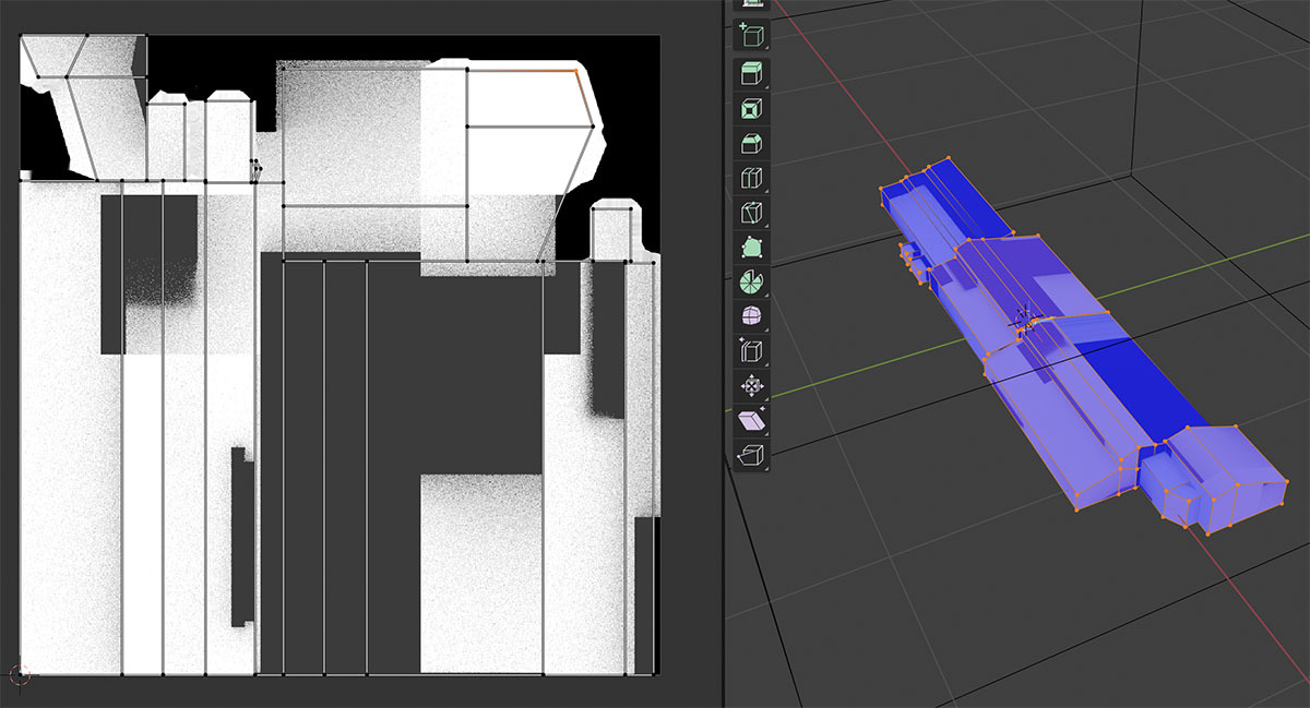

        Did you check your UVs? There could, for instance, be overlapping islands…

          I am not really proficient with UV yet, but I tried to follow tutorials closely and dd smart UV. See attached; however, even in the case of different models (I have several similar low poly houses), the result is always like this. My wild guess was that I needed to merge it all with Boolean, but it seems there is no quick way to do that in Blender.

            What are the black spots? Looks like the baking turned out ok from here. Give us a bit more of context, point to where the problem is or describe a bit more of what you are doing or even better, a video recording of the screen to see your setup.
            #83777
            Anton
              Hi Omar! The screenshots above show pitch-black spots all over the model. This is not the intended result. See the attached image where I applied the AO shader as the base color to the model above. The model below has a baked texture as the base color.
              Based on my previous experience with 3d software, these black spots appear when there is a mesh blocking the light. I have encountered that behavior before in 3DS Max and Cinema 4d. The solution is easy — hide an object from the camera, and the model looks like intended. I tried to do so, even deleting everything except the model I intended to bake, but no luck.

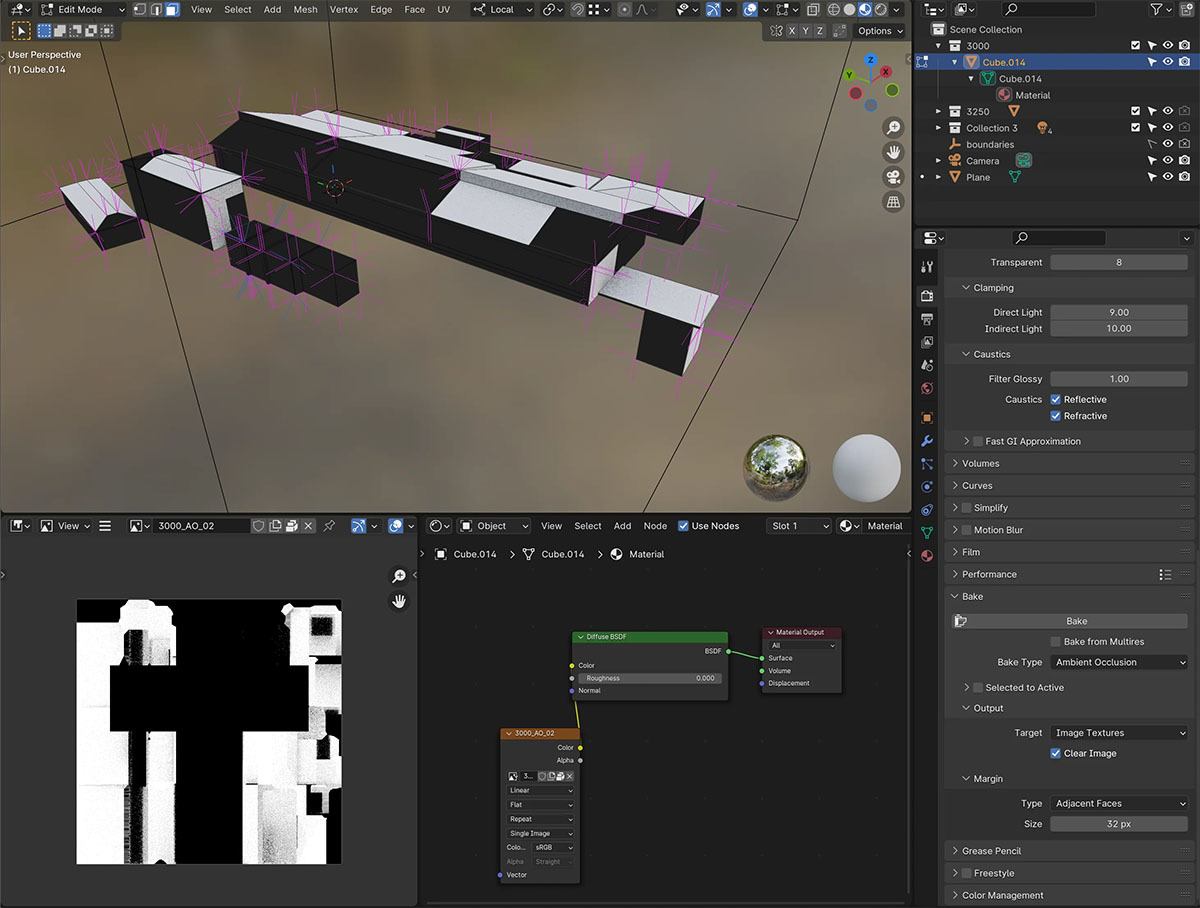

                  Could you have objects hidden in the viewport that are coming into effect at baking time? You can upload your file if you want us to help you troubleshoot, since it’s a bit hard to guess what’s happening via this chat.
                  #83780
                  Anton
                    hey Omar, there are no objects in the scene other than the camera and the mesh itself. Thank you for being so kind by offering help; here goes the scene https://drive.google.com/file/d/1om6Bd08EBb2JikxzxeTk1PYsfwfUyIUy/view?usp=sharing

                      I still think it’s overlapping Faces in the UV Map…look at the amount of Vertices (or Faces) in the UV Editor and compare them with the amount in the models…
