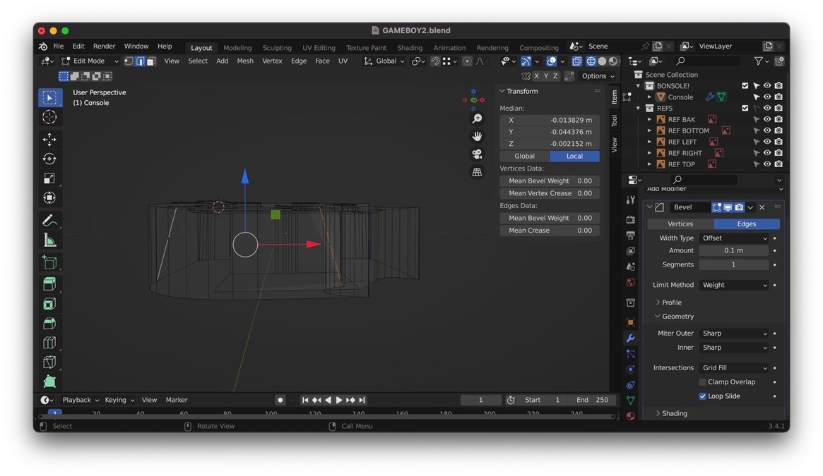

      I have misplaced verts that I have highlighted, is there a simple way to reposition them or fix them to the proper points, will it effect my work moving forward?46BFDB4_1_105_c.jpegthanks in advance !!

        It looks like you have vertex snapping already enabled.
        Go from edge select mode to vertex mode.  Grab the vertex in question and select g then Y.  (I’m assuming that Y is towards the back of the scene, and that you want the lines to be vertical instead of diagonal.).  If you have to instead of using global alignment you can use face alignment, though you may find that Y is not towards the back of the screen for the face.  You may need to use X instead.
        Then just ctrl+click on the vertex that’s lined up the way you want, and your edge should be good.
        You could also try pressing ‘g’ twice to slide the vertex along the edge, then ctrl-click on the appropriately aligned vertex.
        If you would prefer not to have the edges at all you could press x then choose dissolve edges.

          Hey Scott @blake4xx ,
          I might be wrong, but it looks as if there is more wrong, than just a few misplaced Vertices (especially near the orange Edge).
          Could you post another Screenshot when you fixed those Verts with Wardred’s tips?

            Hey big thx for the knowledge @Wardred and Martin. I’ve tried every solution, although i may be missing a step or made an error somewhere but im not going to stop trying even if i have to restart again!
            grabbing the verts are are pulling the model and forming weird shapes, so then I tried just grabbing the vertices and ctrl+click along the Z axis. not sure if that was a solution or i mucked up even more ! I dont really recall understandiing Global alignment vs Face alignment that well, maybe I need to go back to basics !… thx again for the gems and support guys here is a shot of the result 849F08C_1_105_c.jpeg

              Hi Scott @blake4xx ,
              If you’re up to it, starting over is usually very benificial (and goes a lot faster than the first time!).
              There are some (possible) problems I can see from your last screenshot:
              Not all with a simple one-click solution…You can Delete the problematic parts and carefully rebuild them…(or start over).
              Something to pay attention to, is, before you use F to Fill something, make sure you have the correct Vertices Selected (and not too much!).
              And most importantly: Don’t Give Up!
              #80275
