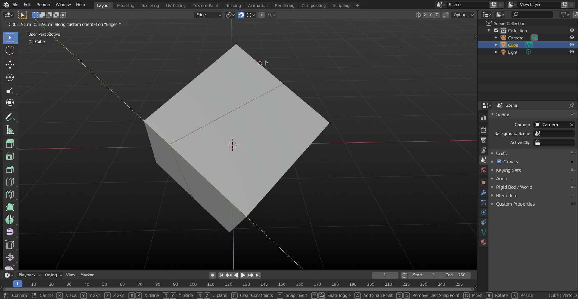

You can’t, but there is a work around; make the edge you want to slide the vertex along the custom transformation. Then move the vertex along the Y-axis while using that custom transform:
