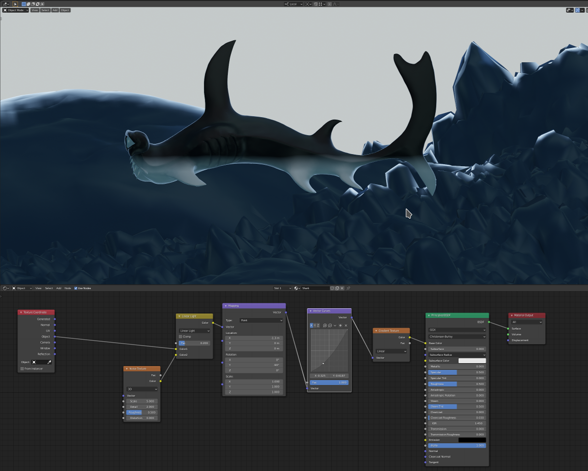

      I did the hammerhead shark and the way it’s laid out the body is pretty curved.
      I was wondering if there was a way to make the texture gradient follow a curve instead of a straight line.

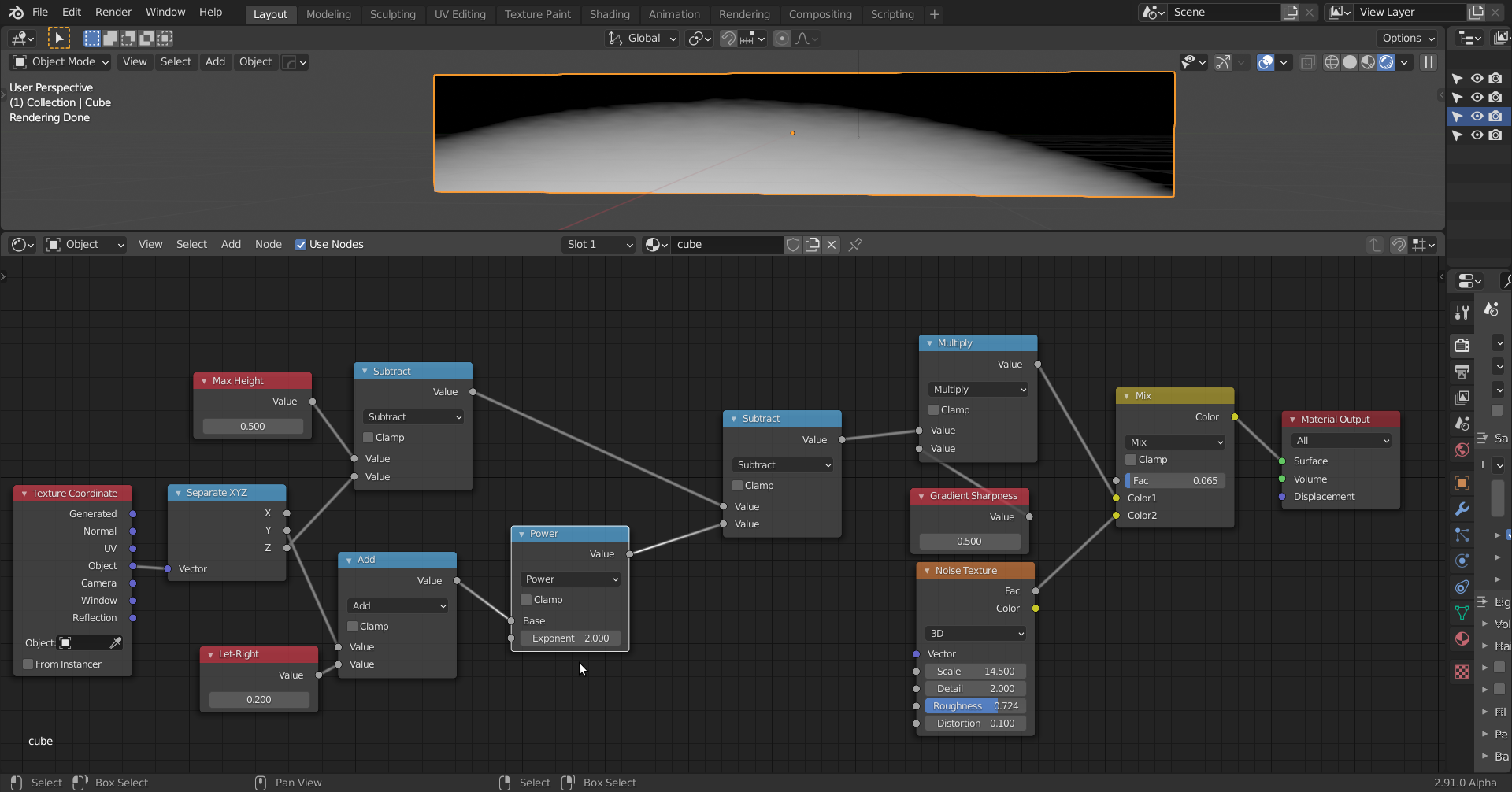

        Sure:
        Here the shape of the curvature is made with a basic quadratiic equation:Z is dependent on x² (Power Node).
        By changing the equation to a higher degree polynomial, you can get more ‘waves’ (ie: more ‘max and mins’)
        Try to understand what is happening  and then ask questions if something is not clear 😉
        #60967
          Or,using a cubic:
          Just fill in the Y values where the Z should be zero (or a, if you change the Height to a).
          I left out the Noise here, for clarity 😉
