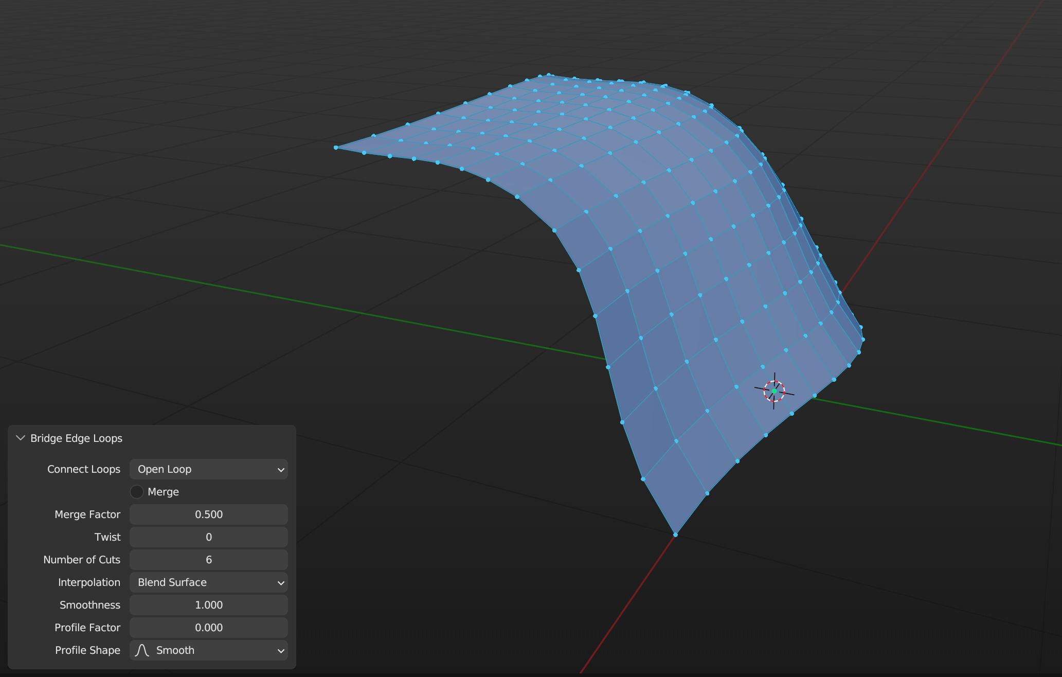

          I don’t think you can create a surface from the curves themselves unless you use geometry nodes, but you can easily loft meshes using the Bridge Edge Loop tool. You’ll need to convert the curves to meshes, but once you do that then you can bridge and use the following settings:

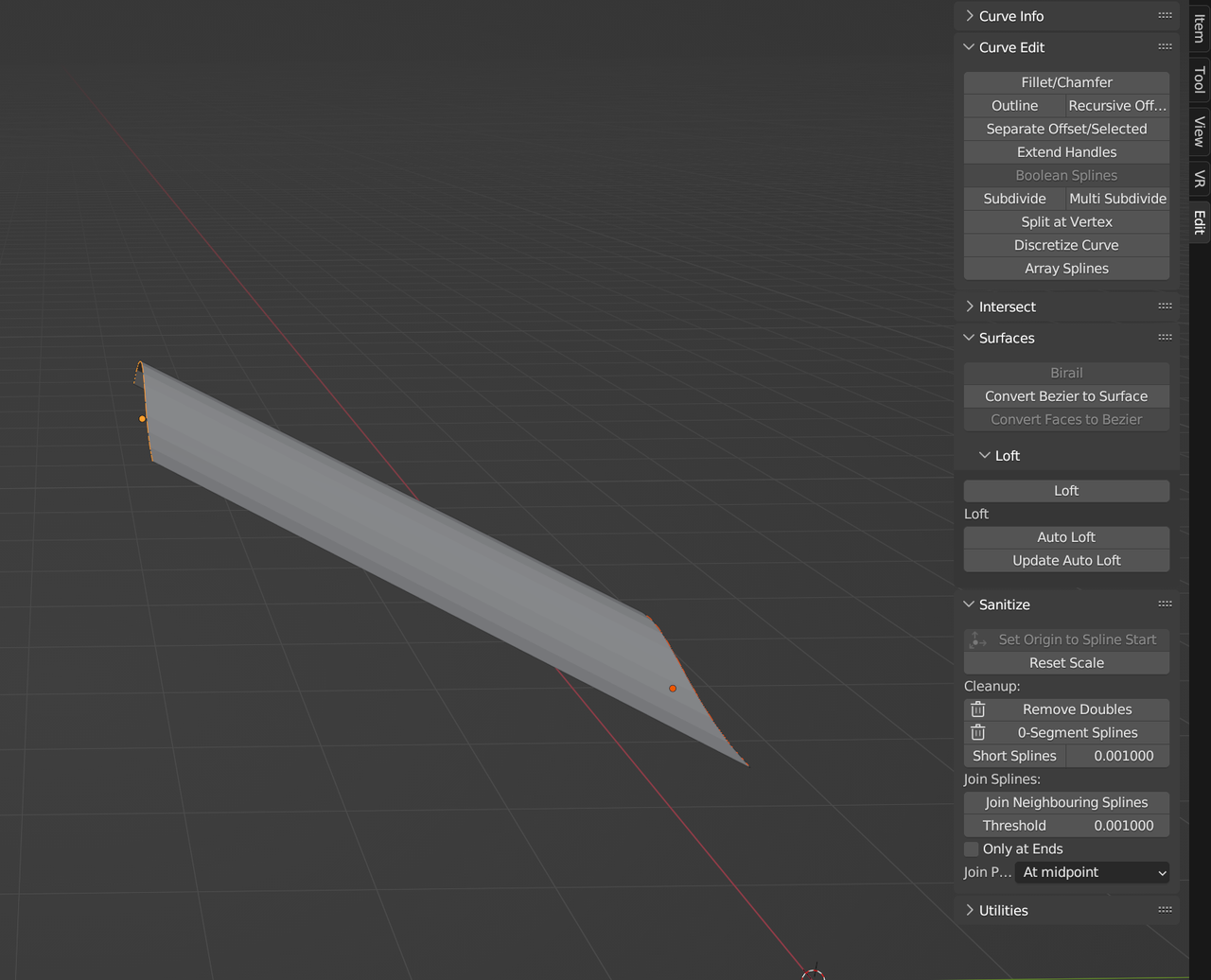

              And there is an Addon that comes with Blender: Edit > Preferences > Addons > Add Curve: Curve Tools:
