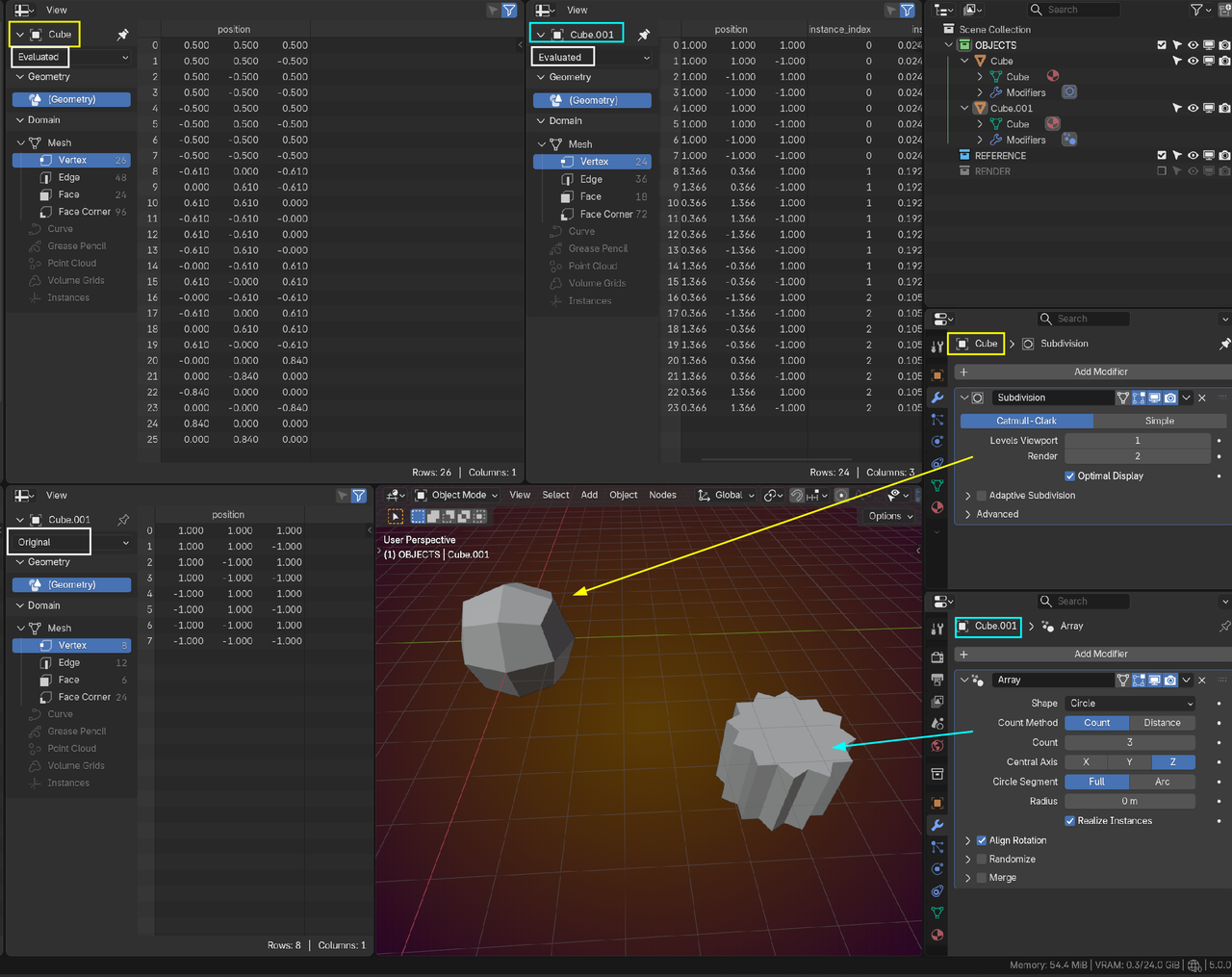

          A Modifier calculates a new list, based on the existing list and keeps that original list, so if you make a change in Edit Mode, you change the original list and thereby also the Modified list.

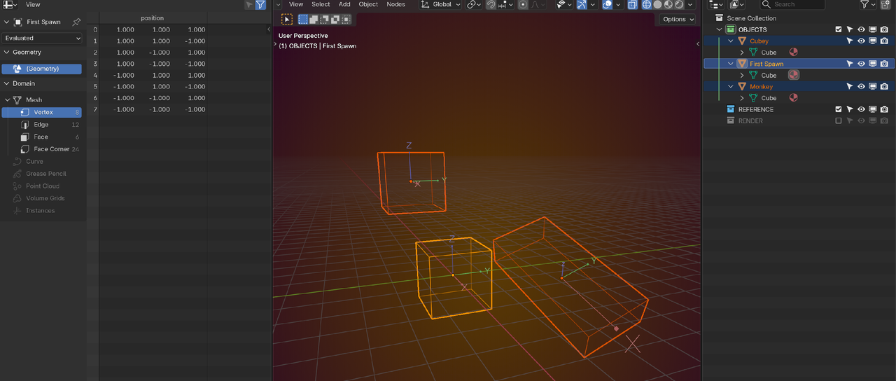

          The really cool thing is, that you can have different Modifiers for different Objects, even if they share Object Data. So we can do this:

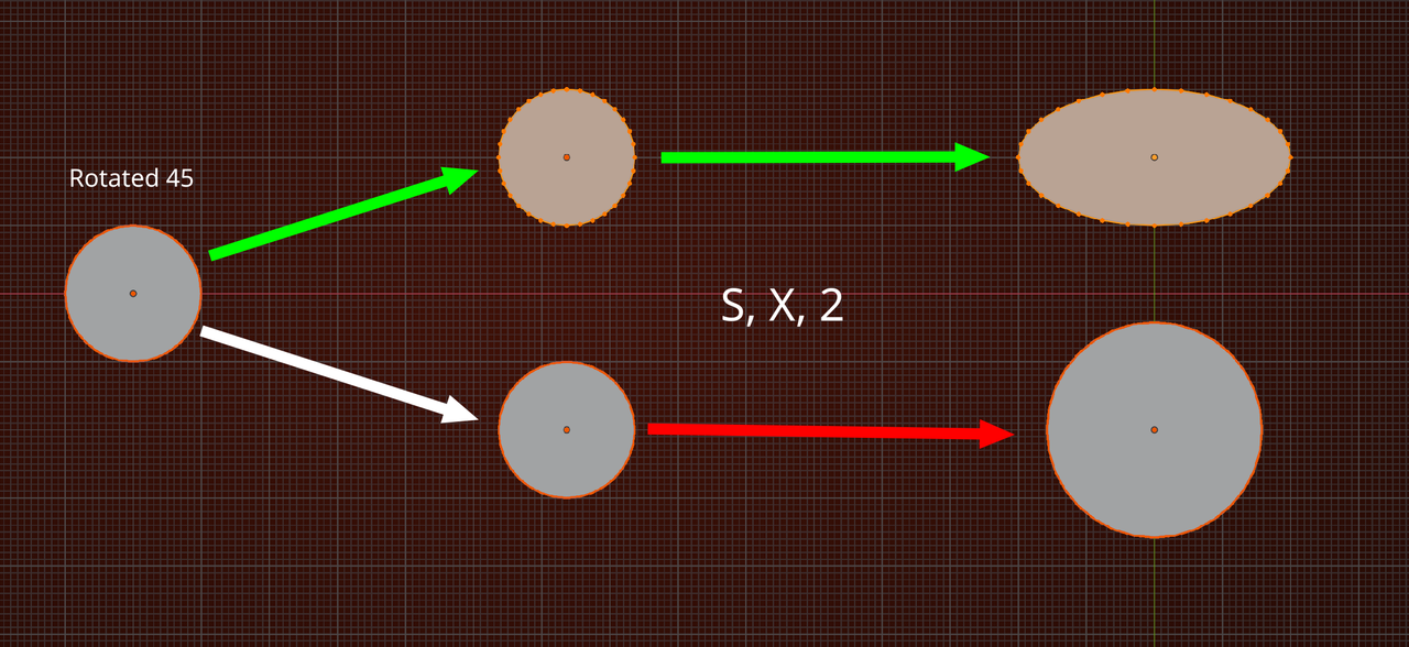

                    And one more thing:
                    Because Coordinate Systems in Blender (don’t know about other software) are always orthogonal, this will happen:
                    Obvcious in this case, but it could potentially create more subtle Modeling errors, if the Rotation is less extreme.
                    Therefore it is better to try and get used to Scaling in Edit Mode instead of. Scaling in Object Mode and Applying the Scale.

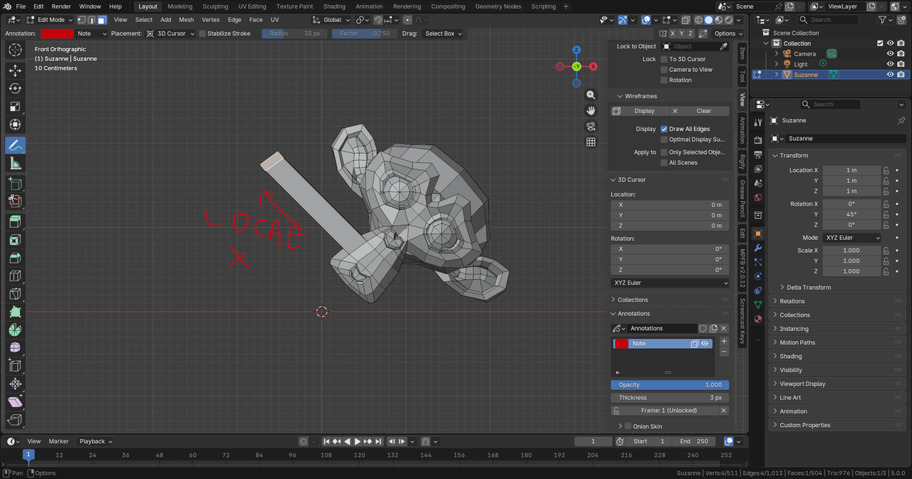

                      (The Object’s own coordinate space is the one we call “local”, because it is the “local” coordinates for that particular object. So just like world space has an origin point, each object also has an origin point for it’s own local space. That’s how we can perform manipulations like rotate, grab, and scale  not only using the world coordinates, but also using the local coordinates. So if the object in world space is at [1,1,1] rotated 45 degrees on the Y axis, if we scale, we can scale along the world X or the X axis of the local space of the object… something that can be very useful at times!)

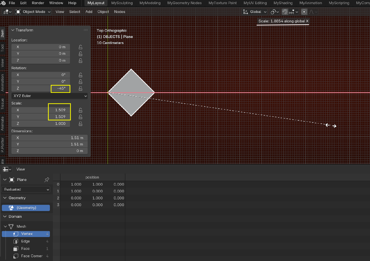

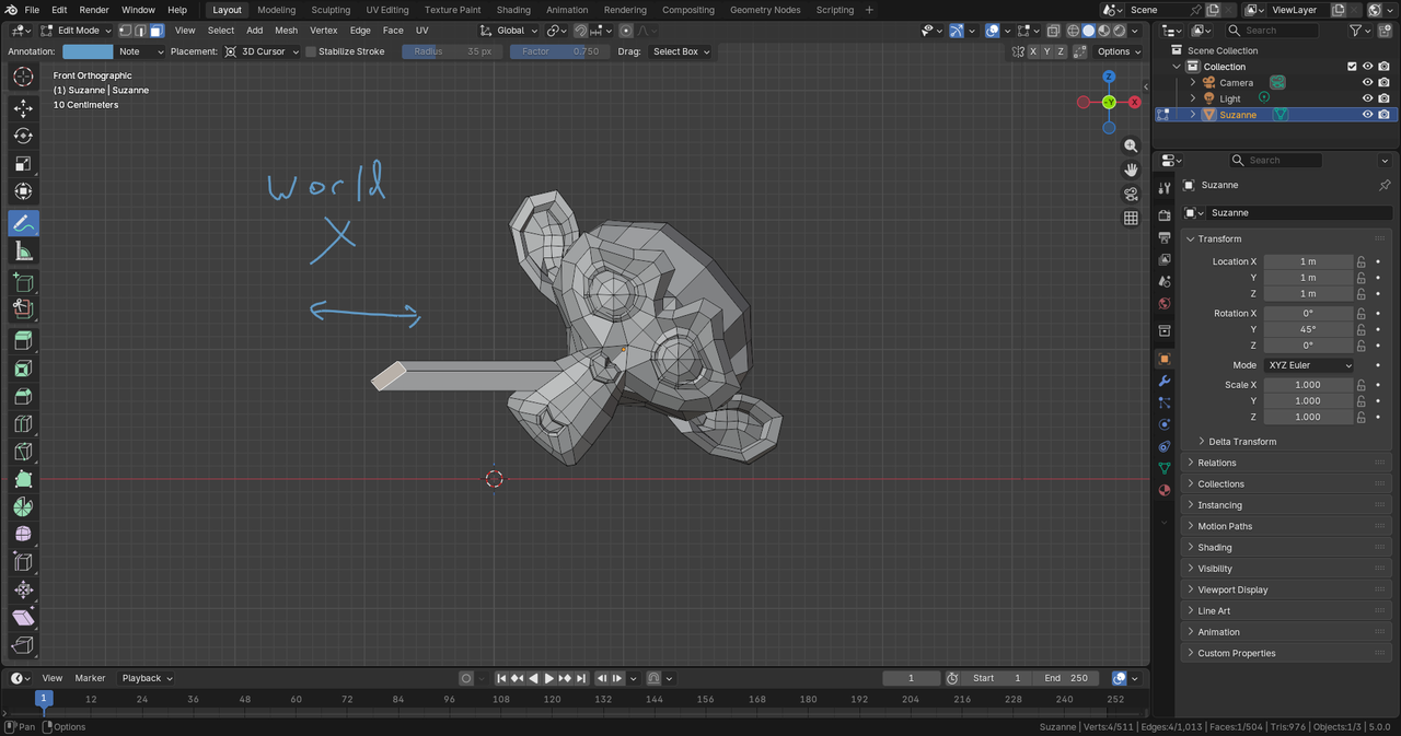

                          Hi Grady @gradyp ,
                          That is all true, but what I was trying to show, is this, a special case, where Scaling in Object Mode (here in Global X-Axis) doesn’t work correctly:
                          Above, I tried to explain why this happens (it’s not a bug 😉).
