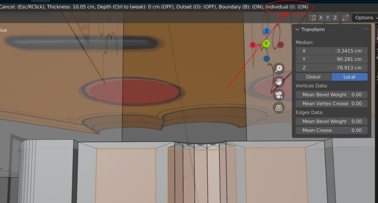

            Here’s a picture of what is happening:
            Individual is Off, but look at the number of Vertices.

                  Hey @terrycarbary@gmail.com ,
                  You are using Inset Individual.:
                  The first I is for Insetting, the second/third/… toggles Individual on/off.
