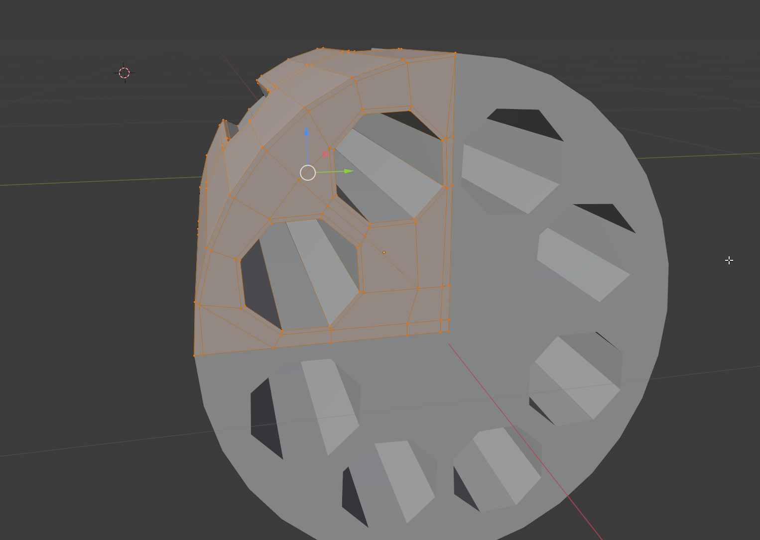

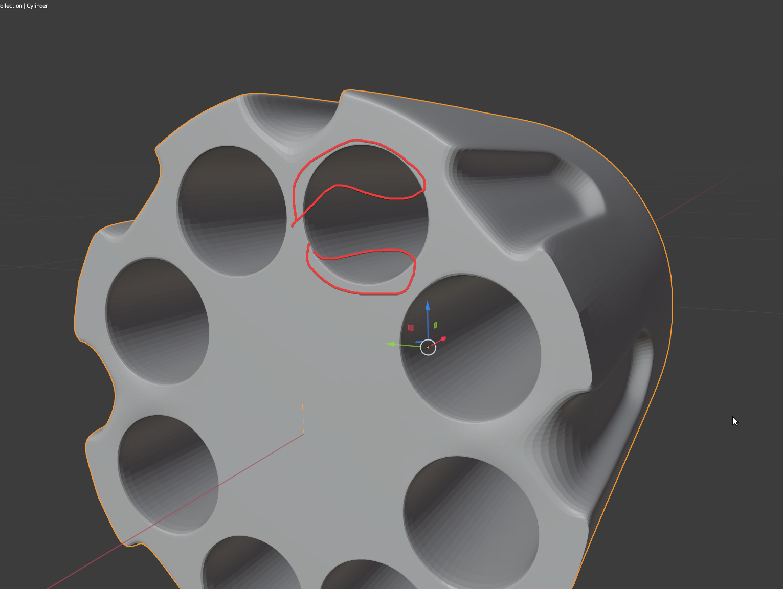

      the chambers are not smooth as the first any idea why?

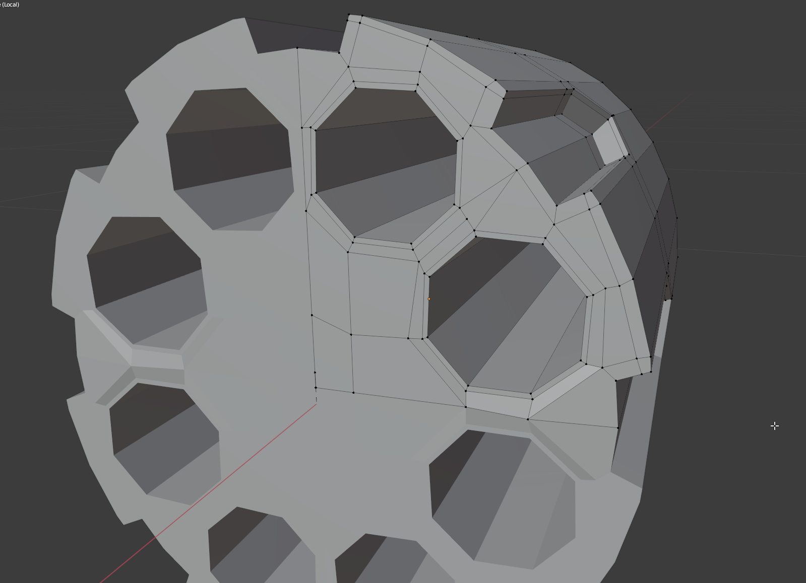

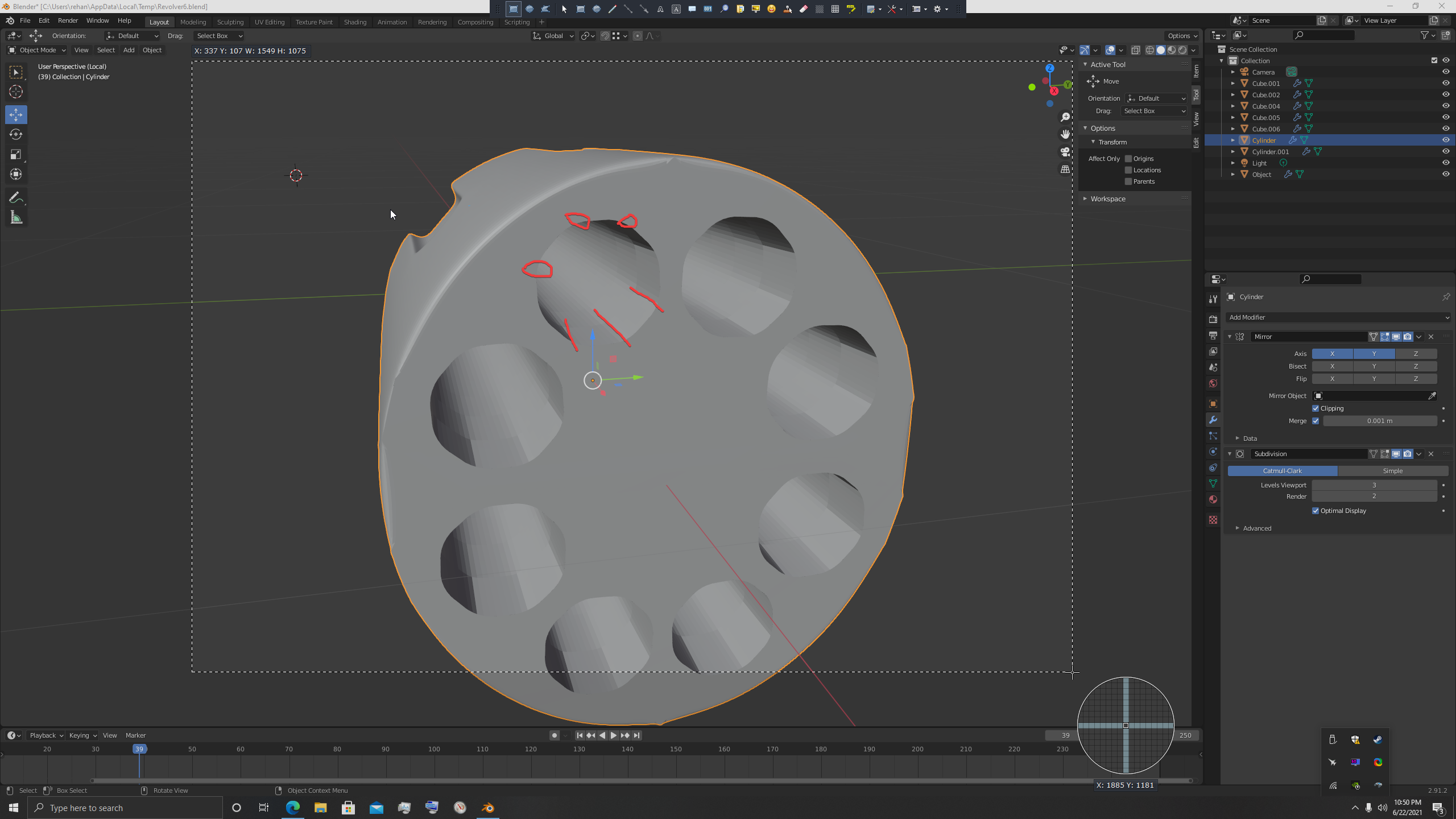

        just smoothed it out with edge loops but still doesn’t make sense how uneven it was even with a parameter loop on the back chambers
        #69229
          My guess would be ‘double Vertices’… It looked like a hexagon with rounded edges in stead of a 32-sided ‘circle’.
          Select All, M > Merge by Distance…
          But I don’t know how you smoothed that out with edge loops…
          #69230
          Jonathan Lampel
            That would be my guess as well, or even if they’re not doubles and are connected, they’re so close together that the smoothing is pinched.
