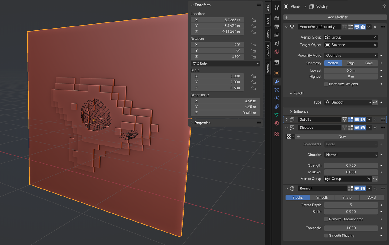

        Hm,
        Some Modifiers could do most of the work for you. For instance:
        #91369
        Pascal Schovanez
          See I have gotten something similar done using modifiers.
          But what I couldnt think of was how would you be able to, using these modifiers, put together a face rig for an animatable character?
          For instance, lets say you for some reason wanted to make the character raise its brow like the rock’s meme (because why wouldnt you).
          I cant picture how you would rig a face that has ‘essentially’ (but not truly since were offsetting it) only a 2D depth to its mesh.
          #91370
            I might not understand you, what you’d do, is Rig a 3D head/face and have the Modifiers on the Plane make it into a layered ‘clay’ look…
