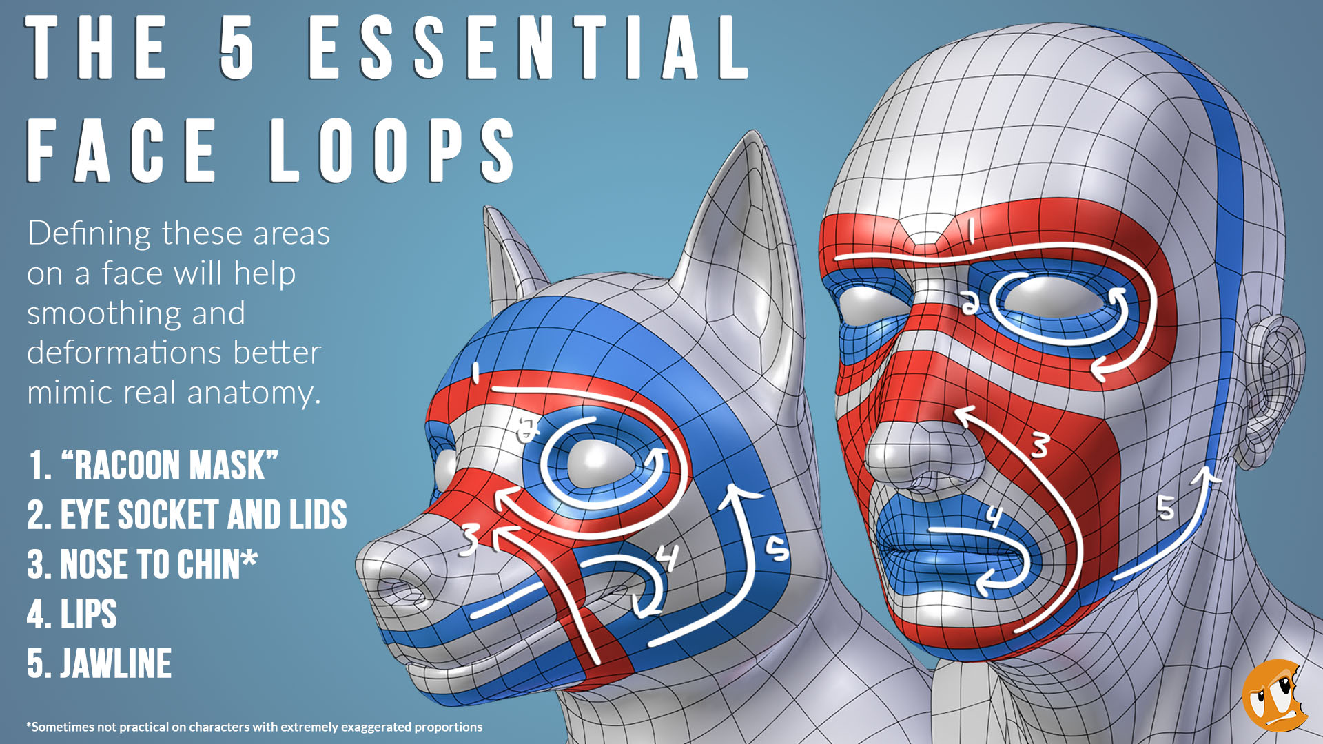

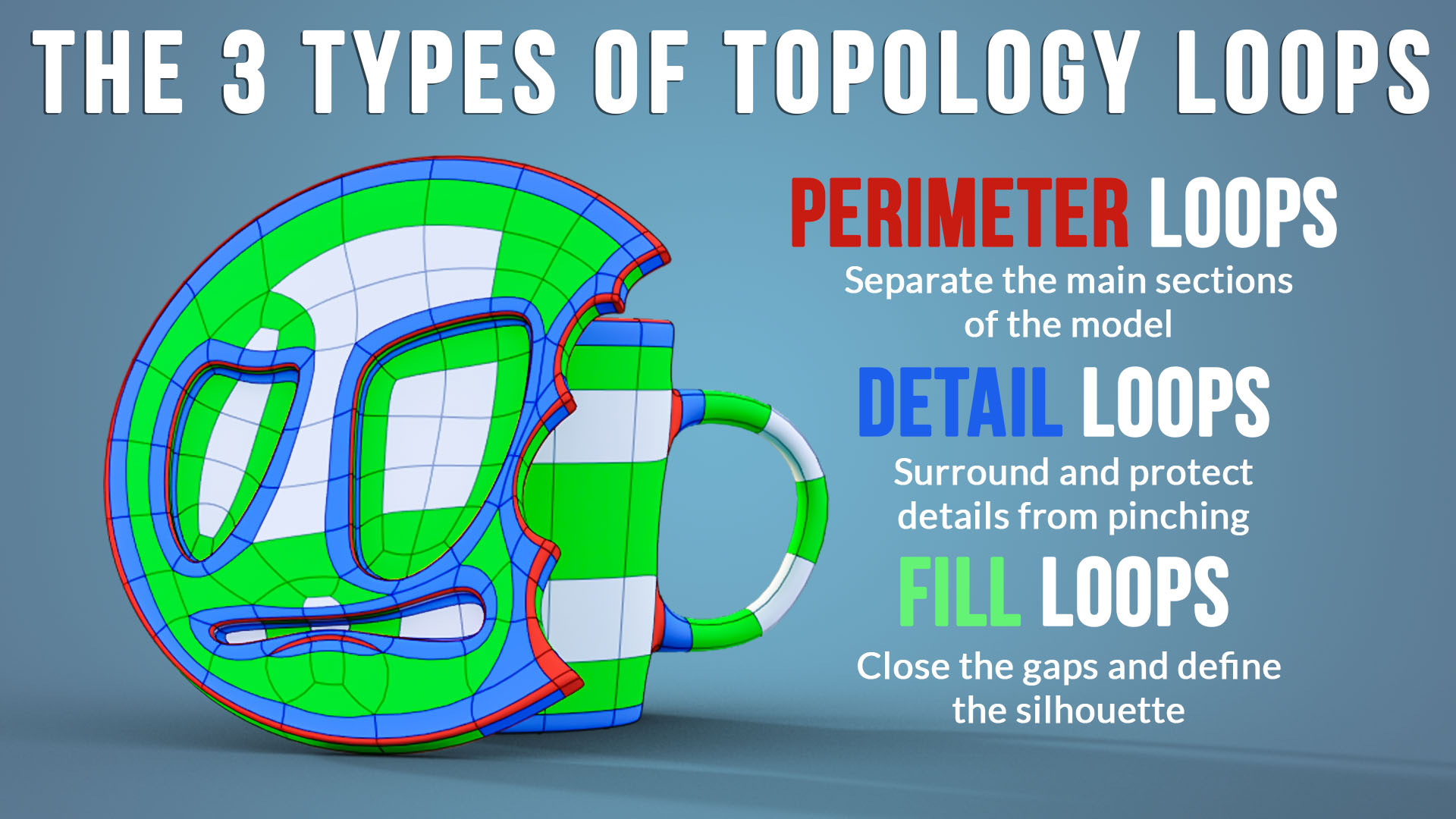

          I’ve updated the Perimeter, Detail, and Fill Loops lesson to include these two cheat sheets:
