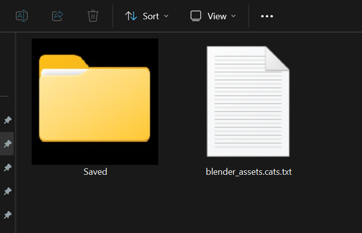

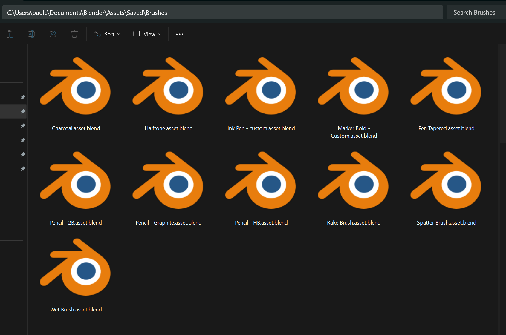

        See, Brushes exist in their own asset folder. Currently, my preferred method is to duplicate and modify ONE existing brush. When it is saved, a new folder is generated in your main assets folder, titled “Saved”. In there, you will see a folder named “Brushes”. And this is where your custom brushes will live.
        Now, should you download a brush pack – for example, I have one here: https://cgcookie.com/downloads/paul-s-grease-pencil-3-0-brush-pack – you can unzip all those brushes into that folder, reboot Blender and they will be available in your Brush assets.

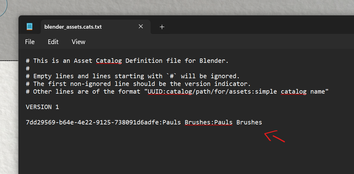

        There are still bugs, however. When you create a catalogue, a new file is generated in your Assets folder to keep track.
        However this can get messy, if you change your mind. Don’t worry though! You can delete this file and start over (Nuclear Option) or edit the text file and remove or relabel Catalogs there.

            Noooooot quite, Nathi! Duplicate ONE brush, tweak something and save it – this will generate the Saved/Brushes folder. THEN take all the brush.asset.blend files and drop them in there. That will save you ALOT of time!

                  If you have any custom brushes you’ve downloaded or created, you can literally drag-and-drop their brushname.asset.blend file into that folder – not in Blender, in your OS. Quite blender if it’s open; restart, and those brushes should be available.

                            Currently this is my preferred “no fuss” way of working, but should you wish to create a brush pack, then saving the brush as an asset is how you do it. These files are self-contained .blend files – name.asset.blend – and you can edit these like other assets. Where you file these away is completely up to you, just know that a .cat file will be generated and updated wherever your library is created. Often when things go wrong, this file is not updated or is corrupted, and you can either go into the text file and manually edit (if you know what you are doing) or simply delete the files and get Blender to generate a new one.

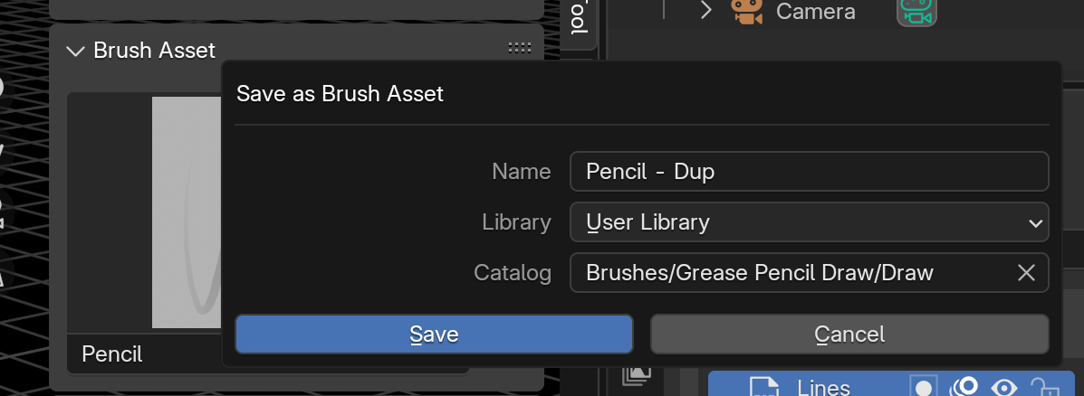

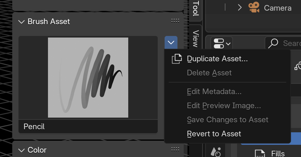

                                If you duplicate a brush(at least in 5.x+) it will let you choose the name, library, and category. By default it will use the user library and the same category and name of the brush you duplicated. You can create new category thru this also. If you decide to change the category just click the dropdown arrow to the right of the tool icon under the tools/brush settings and click Edit metadata. click in catalog and select the category or you can type in a new one. Note: you set the subcategories by using forward slash.
