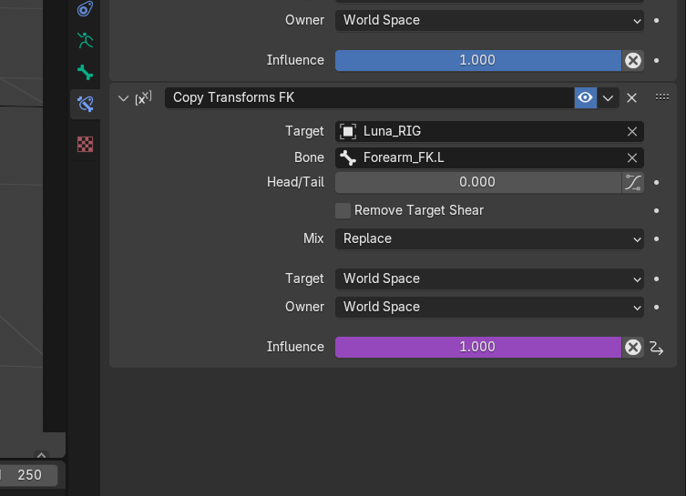

      I’ve uploaded my file to https://drive.google.com/file/d/1frLzjTdyQUedW9LgaOFFgFL0fmhzMokN/view?usp=sharing
      I can’t get it to work properly. Also using the script I get an error \Error: Python: Traceback (most recent call last):
       TypeError: bpy_struct.driver_add(): property “pose.bones[“MCH-Forearm_switch.R”].constraints[“Copy Transforms FK”].influence” not found
      #95364
        Enter Wayne
        #95365
        Dwayne Savage
          You have the left one selected. The file you uploaded doesn’t have the Right side switch bones(MCH-Forearm_switch.R). Also you have lowercase arm instead of Arm for the right side DEF bones.
