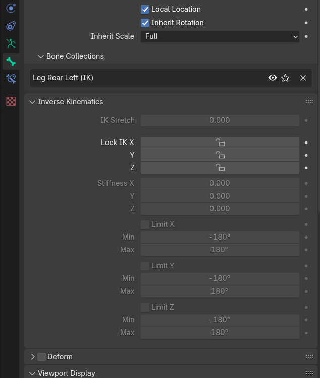

      But, I’m playing around with the IK bone properties tab. Under Inverse Kinematics we have the ability to lock the axis and apply stiffness to them, as well as set the parameters for the min/max rotation. This stuff wasn’t covered in either the Core, or RIG courses (Aside from the IK stretch) Unless it was and I wasn’t paying attention?
      Is it either because it was out of the scope of/not relevant to the course, or lesson. Or is there a chance it could allude to funky animation? If feel it could have been handy to apply them to the crane and turret rig exercises?
      I’m applying the min/max IK rotation to parts on my robot’s leg where it would otherwise cause the mesh to clip through other mesh. I also feel that it creates the desired motion of how the chain parts would move (ie. part A of the robot leg only rotates so far and stops before the mesh clips).
      TLDR: Should I be wary with playing with these settings and what implications (if any) could arise from them? Or is it cool bananas to set them up? OR (sorry another one), should I explore setting up constraints to set the parameters instead?

          Those settings are generally used for mechanical IK. Which I think you’ve already figured out based on how you describe your use case. As for the slowing down instead of an abrupt stop, that is more of the animators job. You’re overly complicating your rig. Also animators usually like to have more freedom with a rig than it to be locked down. With that said, yes play around and definitely try out your ideas on having the rig slow it down and other ideas you come up with. In rigging community this is called playgrounding or prototyping. You may not need it or use it for this rig, but it will lead to learning and building a foundation of knowledge that can be used in other situations. Plus if your the animator then you may want to do both methods(rigged and animated) to get a feel for what animators what a rig to do.
