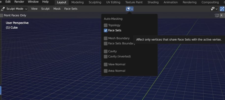

      For anyone who wants to try and follow along with the new vertex paint system, Sculpt Paint, I learned that you can mask areas in order to specify colors like this: create a face set on the area you want to color, select color filter and set filter type to Fill.  Go to Active Tool Workspace Setting (the wrench in the Properties window) >Options>Auto-Masking and select Face Sets.  Then click on the area that you want colored and drag to the right.

          And for the future: in 3.4 (release expected December 7), the Auto Masking has been moved:
