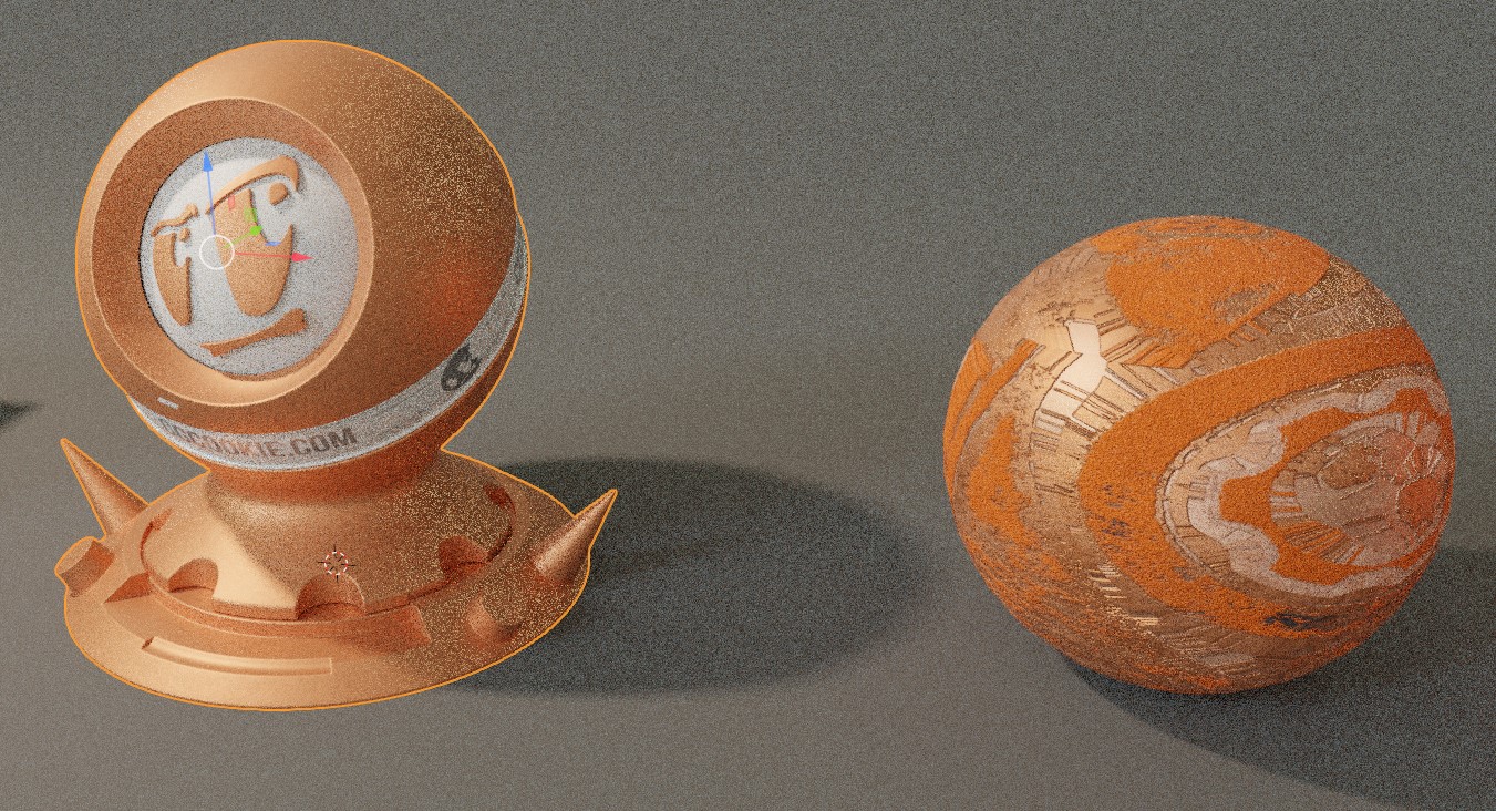

I setup the material with the Metal files (Base Color, Metallic, Bump and Normal) but the Totem doesn’t show them whereas the other objects do, What’s wrong?

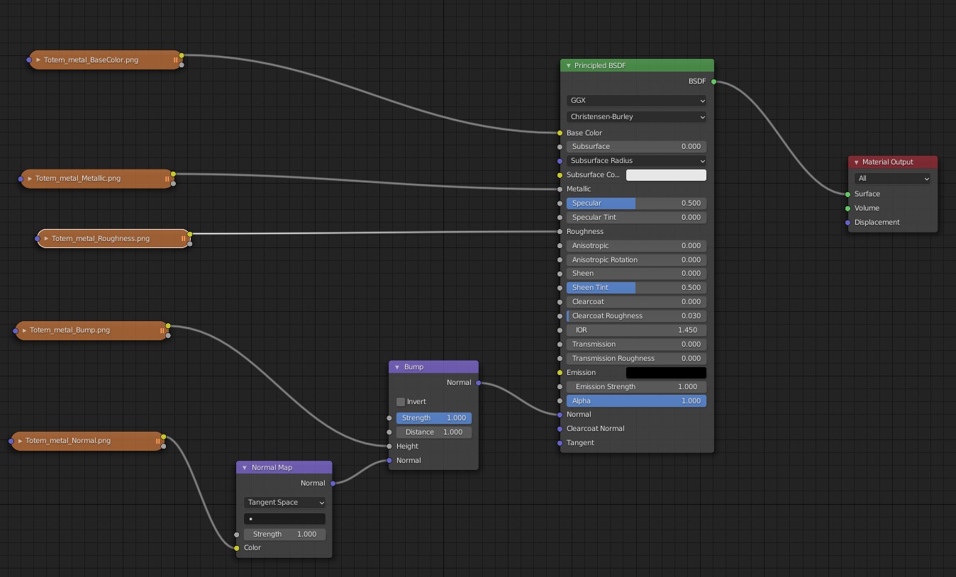

        Could you post a screenshot of your Shader Editor please? (With the Totem selected)
        #70467
        squidring
          Hi Spikeyxxx, thanks for the quick response.  I’ve attached a screenshot.
          #70468
            @squidring I cannot see what you are doing wrong; your connections seem to be correct:
            Are you sure that that is your Totem Material in your screenshot?
            #70469
            Jonathan Lampel
              You may also want to check the UVs – perhaps the UV map got deleted somehow? If you try again with the original source file it should work.
