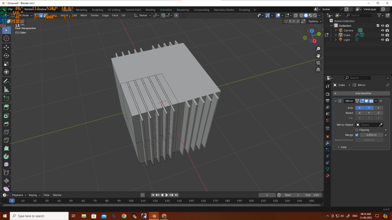

      As you can see, there’s an uneven gap. I could create more edges there and probably fix the issue, but let’s say I only want to use three edges — in that case, would there be no way to avoid the uneven gap? How can I fix it?

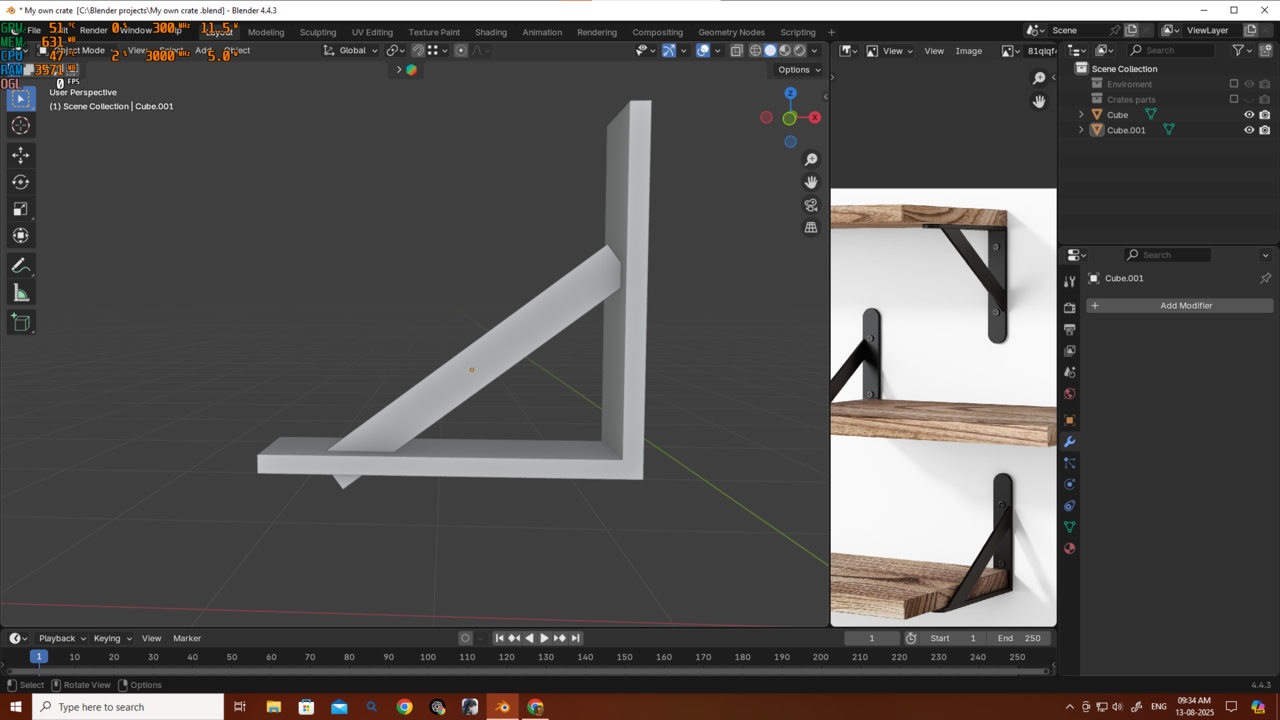

      And here is the obj that i want to fit it diagonally i cant scale it to fit and if i try to move the edges and try to fit its not working either because now the plane is uneven025-08-13 093459.png025-08-13 094358.png

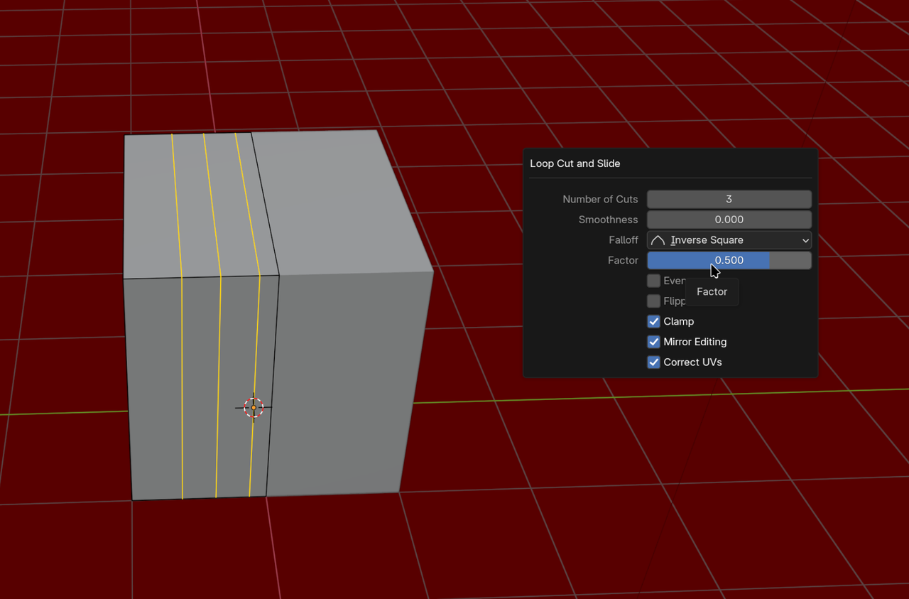

        To your first questiion: you can, when making the Loop Cuts, set the Factor to (+/-) 0.5 (top left corner of your 3D Viewport,, when your still in Slide Mode, or in the Adjust Last Operation Panel, when you’ve already confirmed twice):

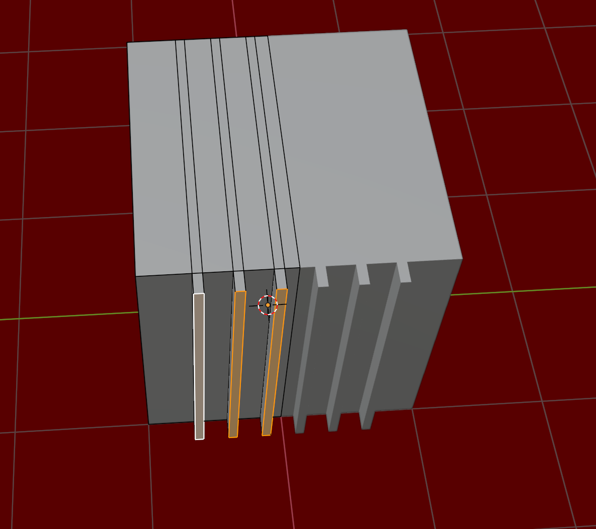

        Then Bevel and Extrude to get this:

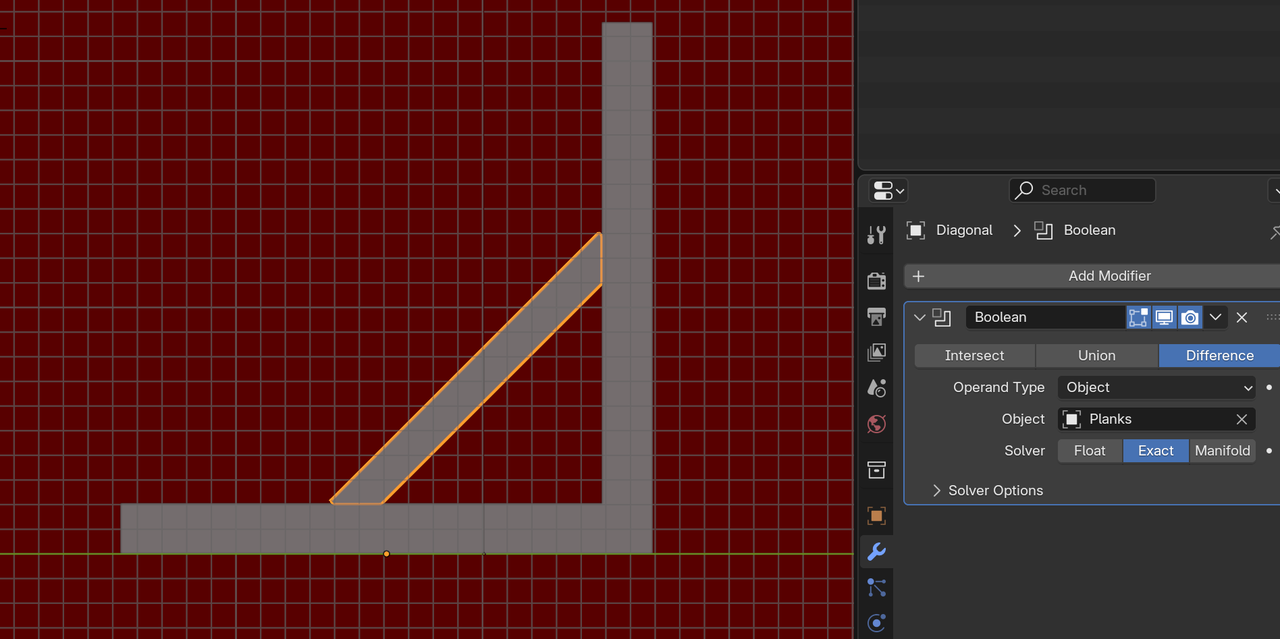

        As for the second question, there are many ways, but the easiest might be to simply use a Boolean:
        #96459
        Deb kanta Guin
          @spikeyxxx plz plz could you explain the Boolean thing here….
          #96460
            Hi Deb,

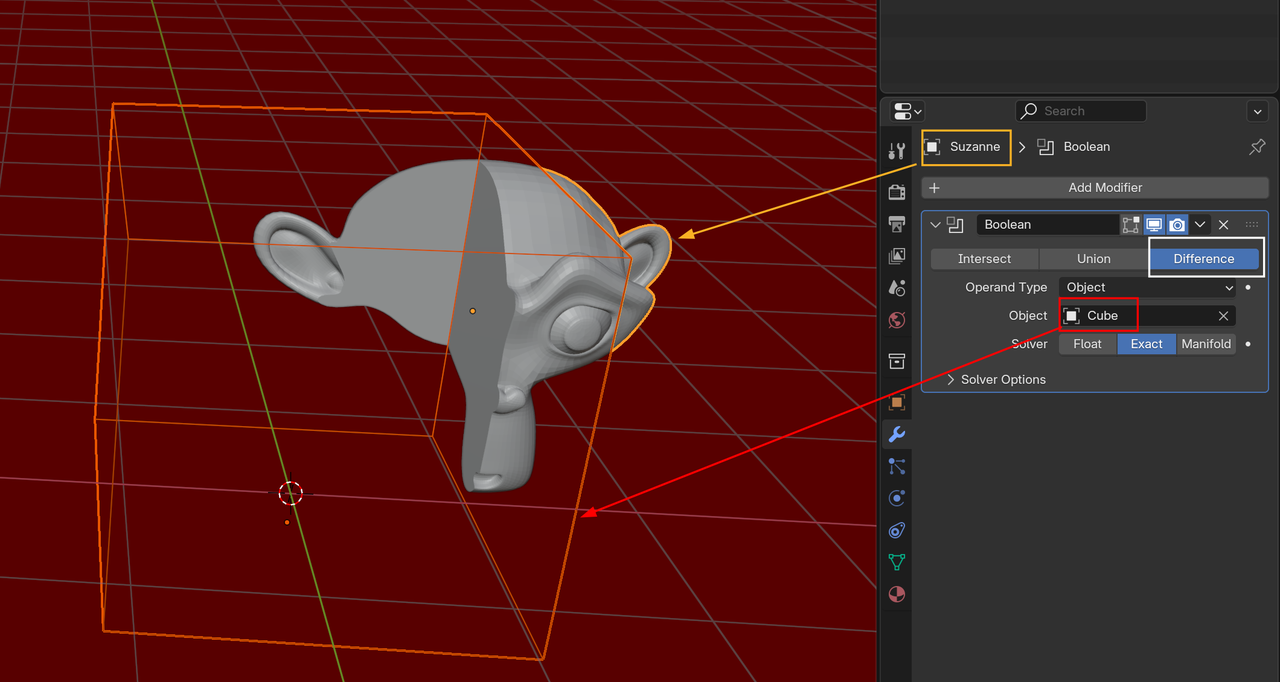

            I used the ‘Planks’ to cut away the ends of the ‘Diagonal’. That’s what a Boolean Difference does.
            Here’s another example: the Cube is cutting away part of the monkey (sorry Suzanne, it’s not as painful as it looks, fortunately)):
            Boolean Difference is like a 3 dimensional subtraction; Suzanne minus where  the Cube is.
