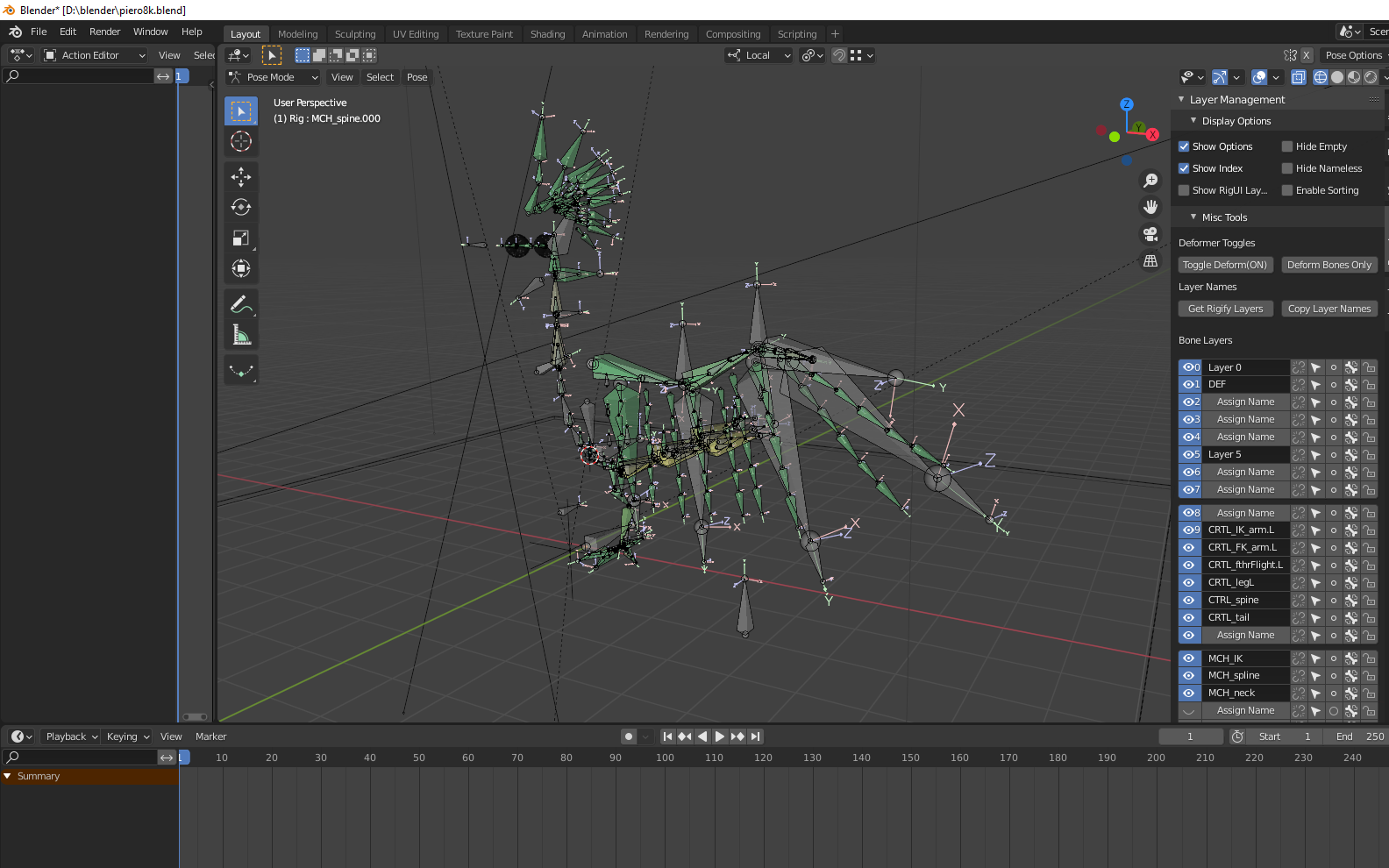

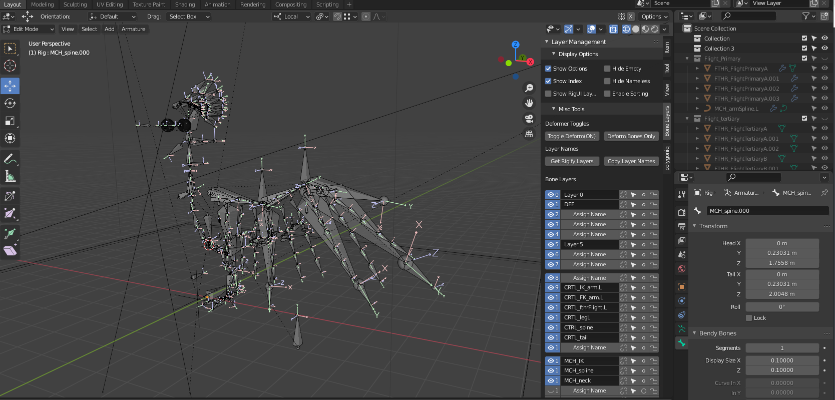

      Hello, I have question, why is my Edit mode rig setup is different than pose mode rig look?
      Edit mode look:
      Pose mode look:
      I tried to clear it with alt +r, alt+g, alt + s and nothing helps ๐Ÿ™

        Ok @red-izak I had a quick look. In edit mode you have some bones hidden. Press ALT + H to unhide them. The position of the bones is different in edit mode because of the action constraint, the influence is all the way up at 1. Lower to 0 and they will be back at there original position. If you are following the tutorial step by step check the setting in the tutorial compared to yours if you are using a different version of Blender as the default setting may have changed.

          @red-izak The “Pose Mode” is where you add the various “Bone Constraints” which therefore only have an effect on the bones when being in that mode. That’s why you often  see at least some slight movement of the bones when switching from “Edit Mode” to “Pose Mode”.

                @red-izak  Yes, the “Bone Constraints” start working as soon as you switch to “Pose Mode” unless
                1) you set a constraint’s influence to zero or
                2) turn it off (by clicking the eye symbol in the constraint’s header so that it looks closed) or
                3) set your armature to “Rest Position” (in  the “Skeleton” panel of the armature’s “Object Data Properties” tab).

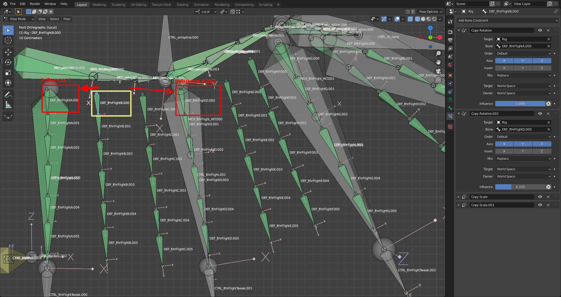

                Let’s look for example at the bone “DEF_fthrFlightB.000” in Piero’s left wing (see image below, yellow frame). It copies its rotation mainly from bone “DEF_fthrFlightA.000” ( “Copy Rotation” constraint with an influence of 1) and with a reduced influence of 0.333 from DEF_fthrFlightD.000. As soon as you switch from “Edit Mode” to “Pose Mode”, DEF_fthrFlightA.000 and DEF_fthrFlightD.000 start pulling DEF_fthrFlightB.000 into their directions:
                 And this causes the snapping of all “Deformation Bones” in between the “Feather Control Bones” CTRL_fthrFlight.000 to CTRL_fthrFlight.003 (the large bones hanging down from the wing “arm”).
                All “Bone Constraints” that copy transformations from other bones can act like this.
                The “Crown Feathers” of your Piero are influenced by the rotation of “DEF_head.002” around its local X axis (Note: “DEF_head.002″should be renamed properly as “CTRL_crown” as well as some other bones in the head (see my rig here)). This bone is in your file rotated 0 degrees around its local X axis. The “Copy Rotation” constraint maps
                1) a rotation of -45 degrees of your “DEF_head.002” bone to frame 1 of the “MCH_crownSpread” action (“Crown Feathers” bend backwards to their extreme position) and
                2) a rotation of 45 degrees of your “DEF_head.002” bone to frame 20 of the “MCH_crownSpread” action (“Crown Feathers” bend forwards to their extreme position)
                This means that  “DEF_head.002” in its default position of 0 degrees rotation aroung its local X axis is mapped to a “Crown Feathers” spread in the middle between these two extremes mentioned above. This position isn’t identical with the “Rest Position” of the “Crown Feather Deformation Bones” in “Edit Mode” so that these bones are spread forwards when switching from “Edit Mode” to “Pose Mode”.
