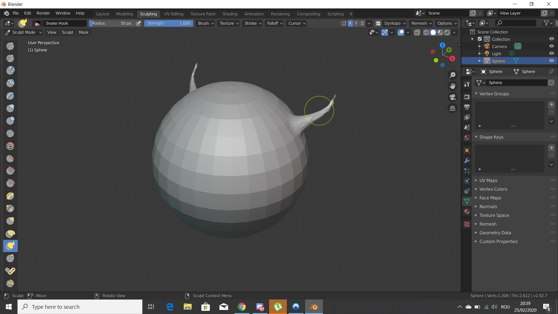

      hey i have got a problem. With dyntopo enabled if i try to use snake  hook it is still kind of streching the geometry and it makes the stroke thinner as i draw. Any help?

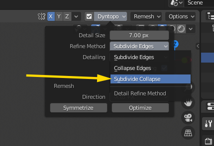

        Try enabling Subdivide Collapse as your Dyntopo refine method:
        Also if the geometry you pull out is too faceted (low poly), lower your detail pixel size.

        alinblender
          well that is kind of ok  when my brush  radius is high but when the radius is small i have the same problem
          #53282
            Ok thanks for the screenshot. Yeah I think you just need to lower your detail pixel size even further. The issue appears to be that there’s not enough geometry to facilitate the stroke.
            Also give Brush Detail a try. That will align your dyntopo geometry resolution with your brush size: Larger brush = larger polygons, smaller brush = smaller polygons.
