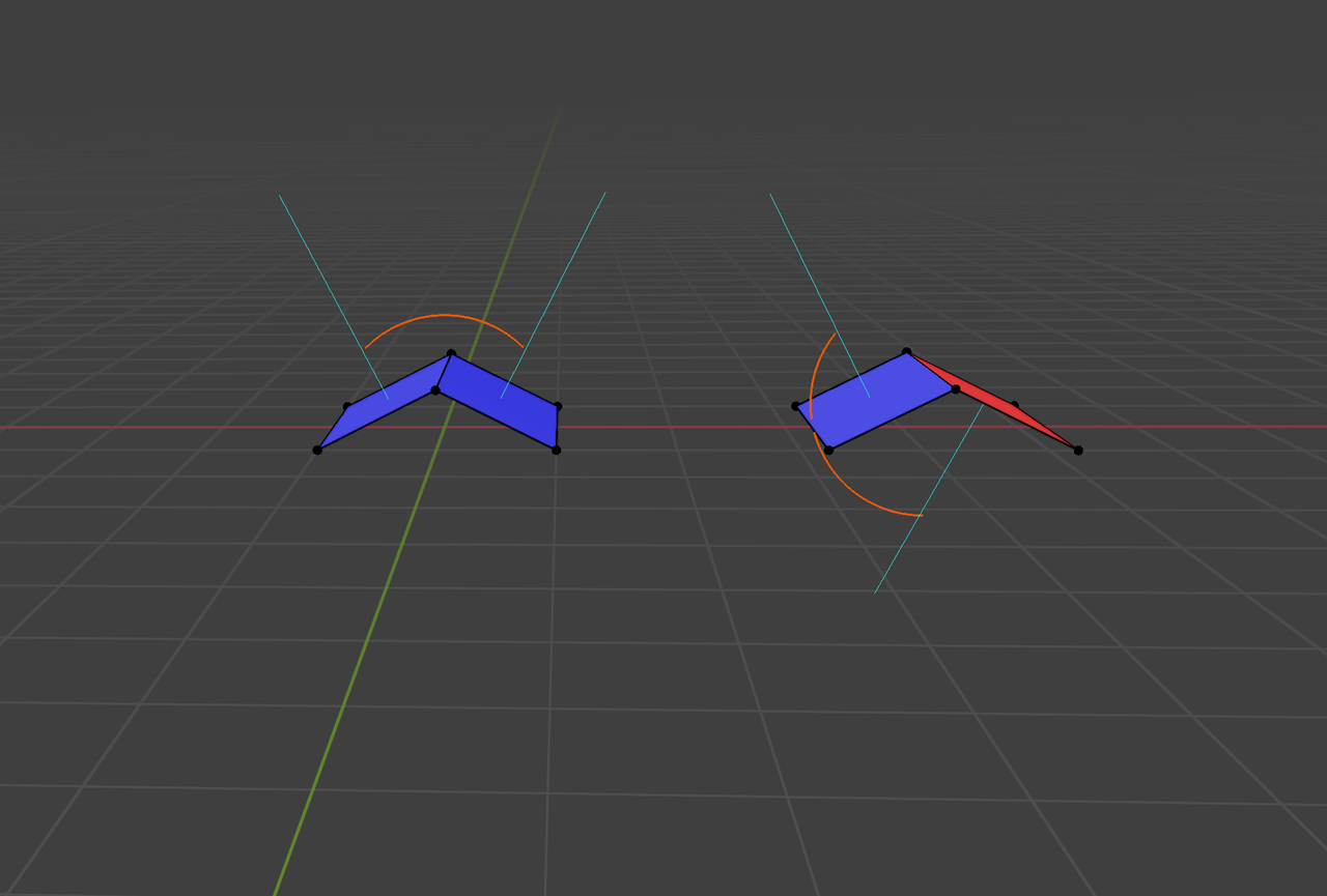

The difficulty is probably mostly, due to the way the Angle between two Faces is measured. It is easiest to look at the Angle between the Face Normals, like so:
When that Angle is larger than the set Angle Limit, the Faces get ‘split’ in the UV Editor. So, in the above example, with an Angle Limit of 90°, the Faces on the left will be one Island and the Faces on the right will be split into two Islands.
