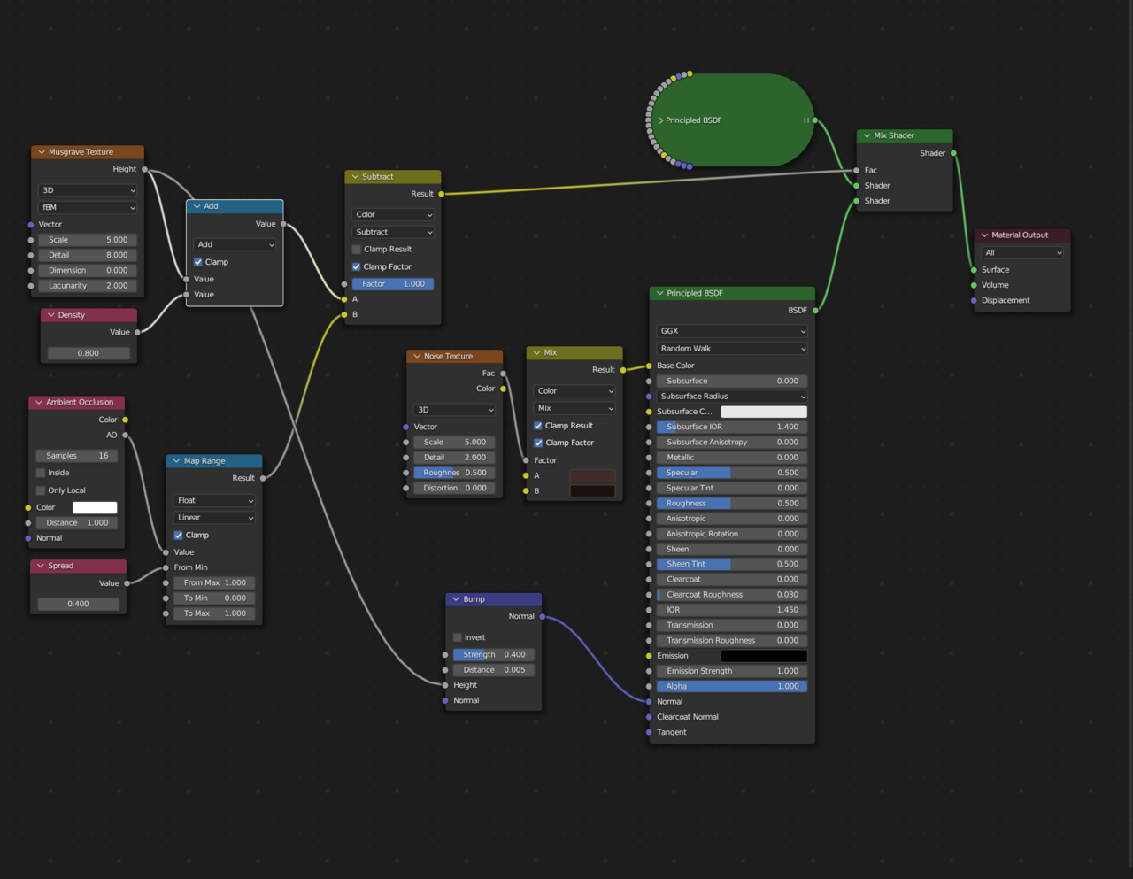

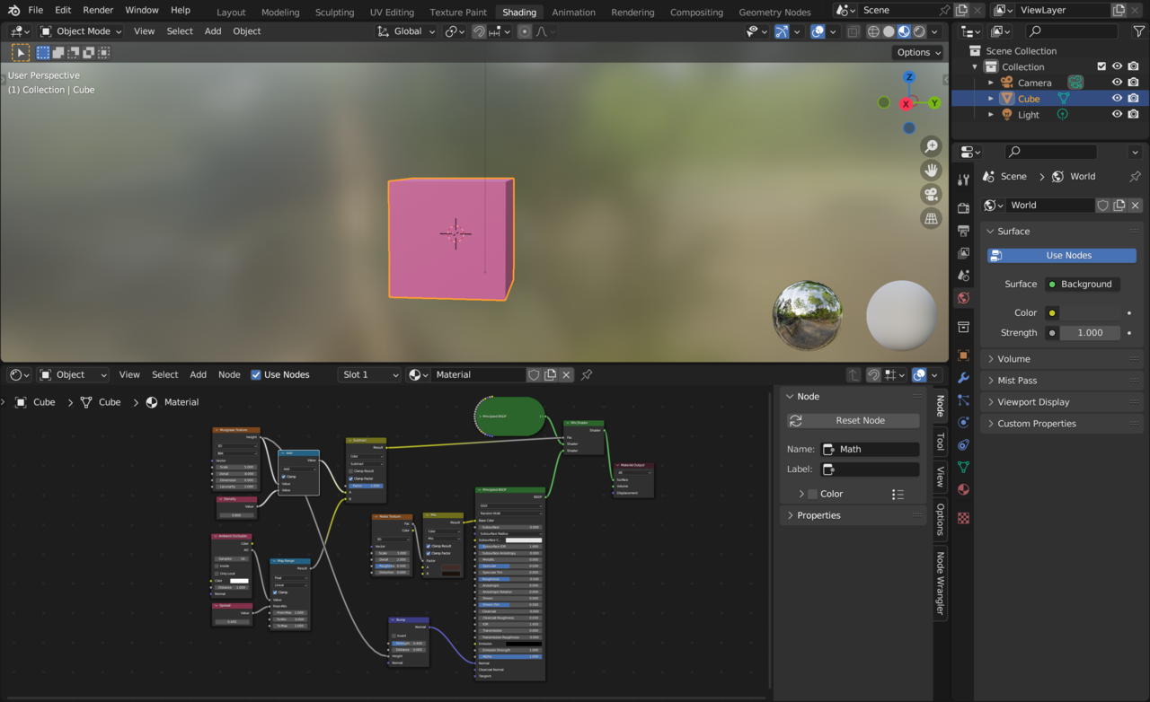

      Hi, i was following the tutorial and coming up with the same results until i added the second principled node. Now I cant see the grunge texture. Any idea Why?a la(s) 10.36.15.pnga la(s) 10.36.27.png

        But how do I attach the factor to the add shader?
        I tried it and it doesn’t change the result.

            Hi Maru,
            You should Clamp the Result of the Subtract Node, you only have the Factor Clamped.
            #86685
              The Mix Shader is correct, but you are feeding it with (partially) negative Values for the Factor.
              #86686
                Also, you need another Object for the Ambient Occlusion to work.
