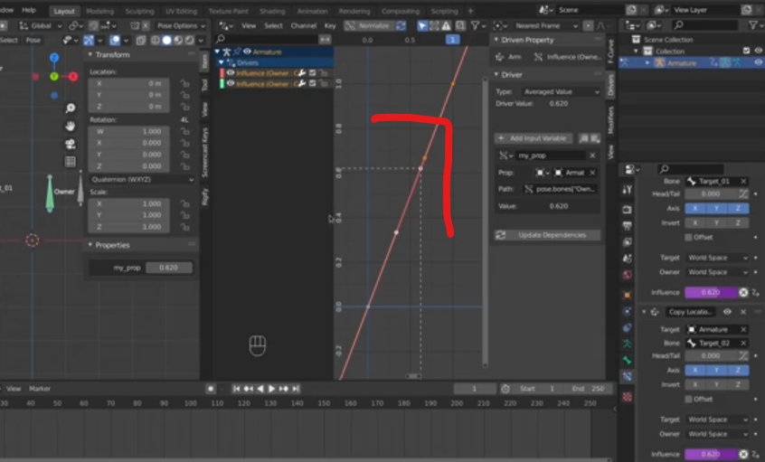

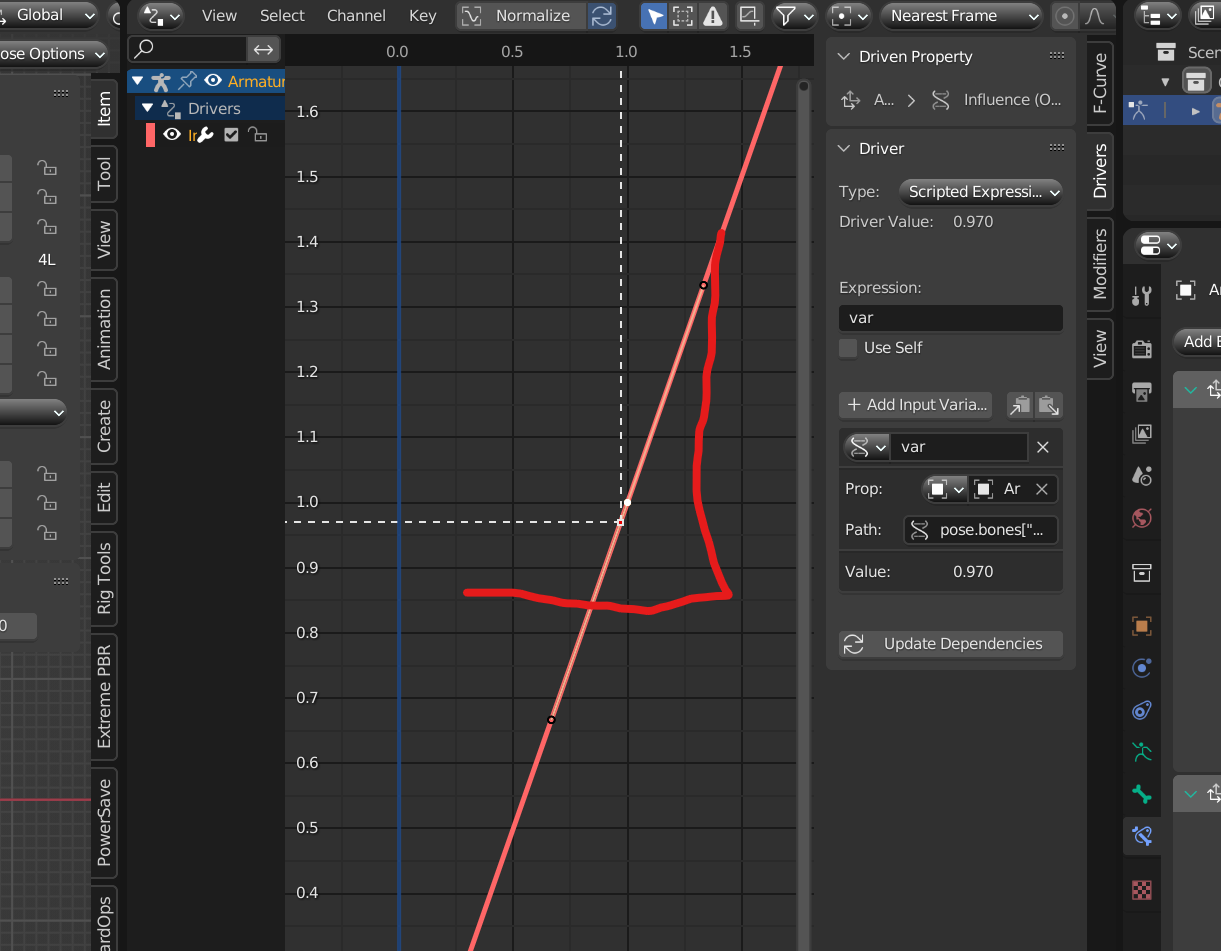

      I have do go through those videos several times to get things done and sometimes it works next time it wont.
      At 11:40 your input/output line is different
      yours
      mine
      I started several times but no result… always like this.  Why is this happening? I use 3.1.2,,, maybe different in this version 🐌❓
      #74283
        Hi Martin,
        that is indeed a Version difference. (Started in 3.0)
        The output numbers used to be on top (with the Frame in blue), but the output line went down, which didn’t make much sense, that is why they now have the output line going up, to where the output numbers are.

              You know what.  I didn’t even noticed this had changed – and I stare at it all day. Haha
              But now it makes more sense.   The bottom (horizontal) is the input, the vertical (left hand side) is the output.
              Now the lines match up more logically.
