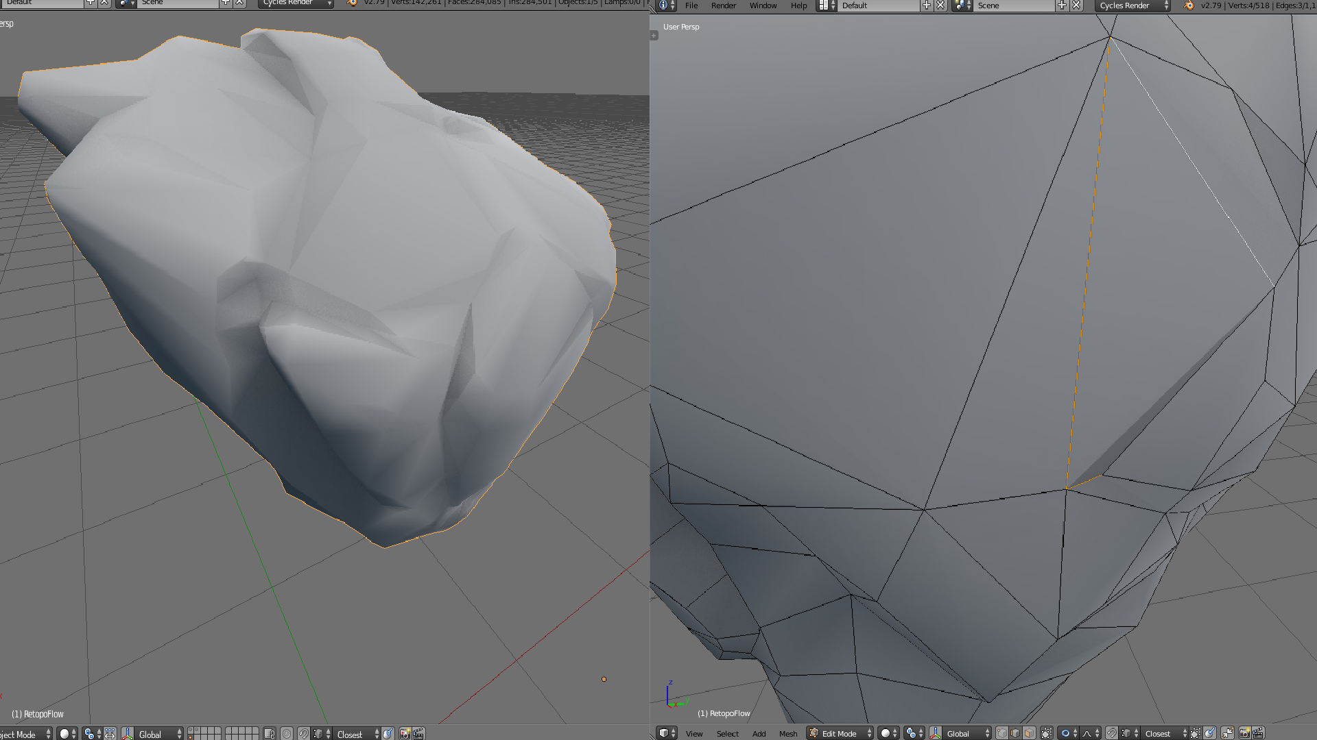

      I used Smooth on 1 picture – model did not smooth where polygons  bended in a sharp angle.
      Second picture – there is a polygon did bend (it is dark)
      I can’t help preventing this happen. Is there a way to avoid that still using the Retopoflow ?

        Looks like the problem wasn’t exactly in Retopoflow, it is my quads were being created not planar but somehow triangulated. I found out that I can use the Mesh – Clean Up – Make Planar Faces to flatten my poligons.
