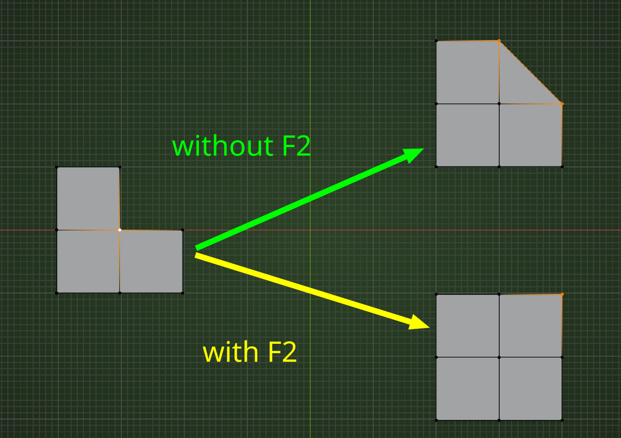

          My guess would be, that you have 2 Objects (not 1), that are both in Edit Mode and that you are trying to connect Vertices of both Objects and that is not possible in Blender. What happens now, is that Blender only uses F on the 1 Vertex of the Active Object and that is when Blender makes a Face from that Vertex. Depending on whether you have the F2 Addon enabled (which you should imho), it will create a Triangle or a Quad:

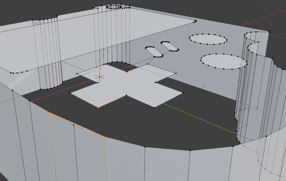

            anon anon
              #97504
                Looks like it is as Martin said, it’s two separate objects.
