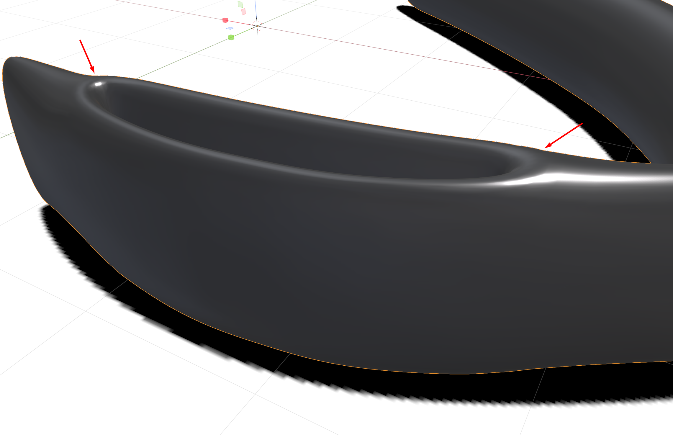

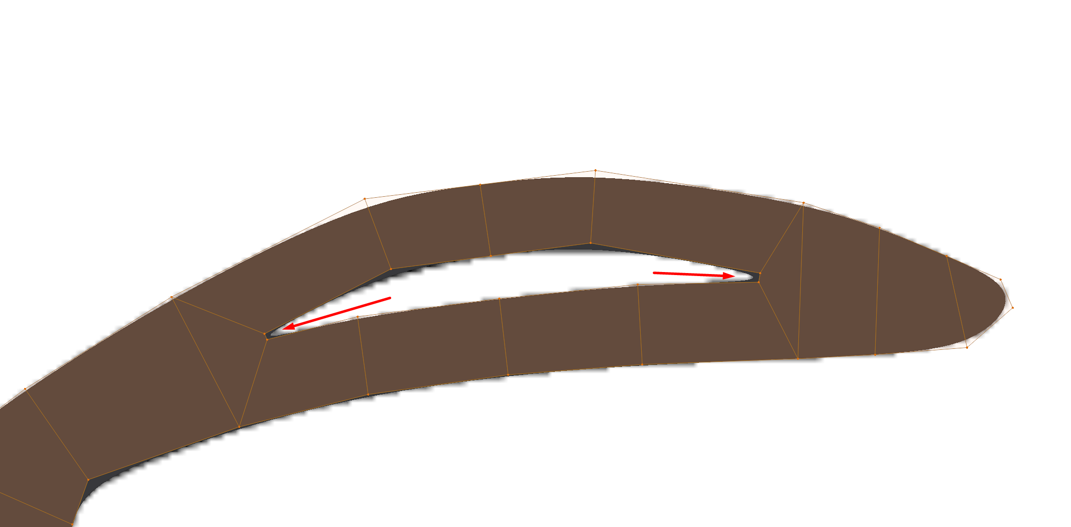

So, here are some examples of my issue. Arrows pointing out the trouble spots. Subdivide modifier is already applied (before the extrude) so I can see where to move verts in order to match the shape to my reference image
Unextruded mesh

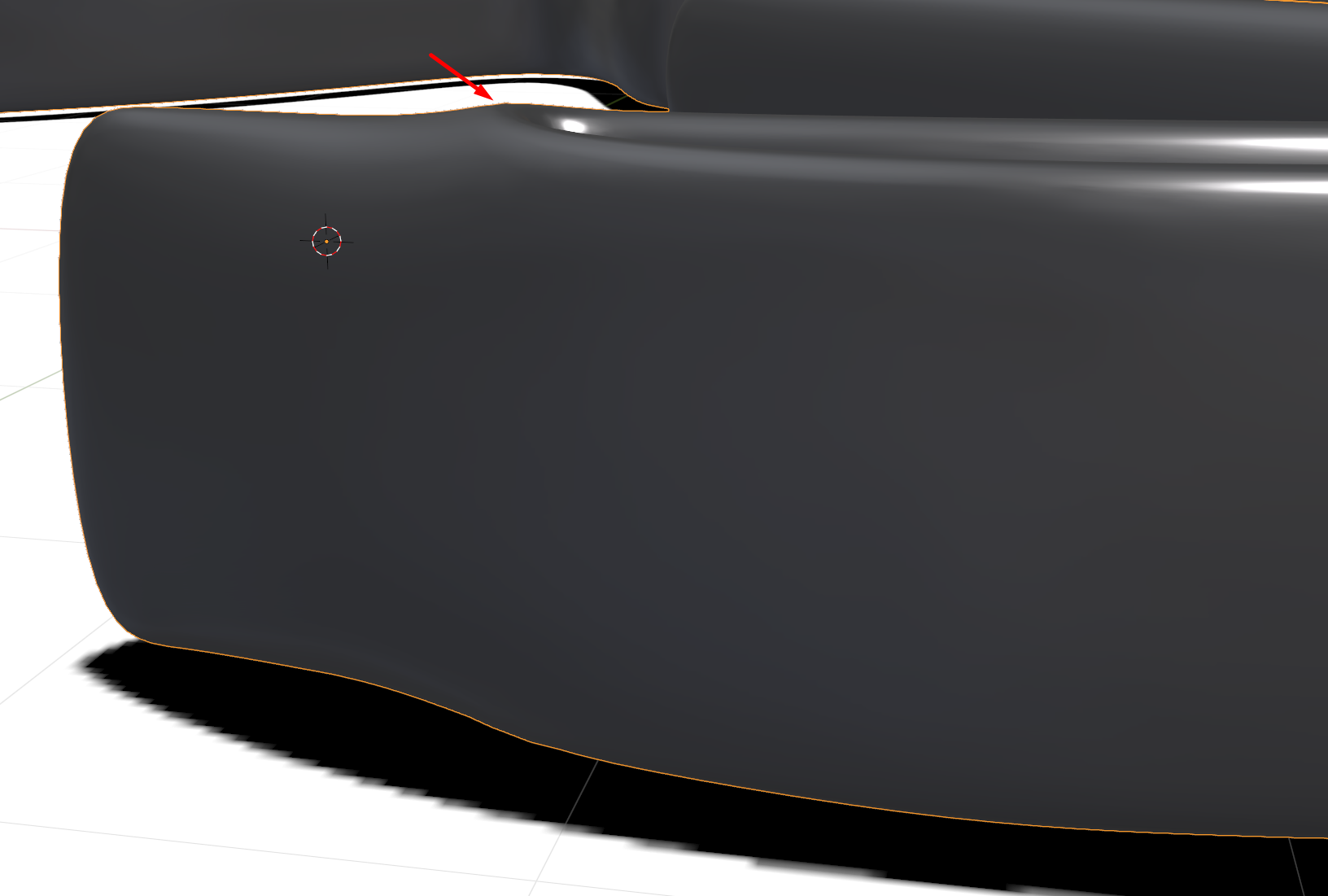

As you can (hopefully) see, there is a ridge that forms at the corners.

I’ve been playing with this for about 10 hours, trying different geometries and vert positions, and this is the best result that I can get. I would like the corners to be flush with the top of the rest of the model. Is this something that I can do by modifying the geometry? Am I going to have to edit the mesh somehow after the extrude? I tried playing with some of the sculpting tools, but couldn’t get any of that to work. Advice or examples would be greatly appreciated.

That is because of the way that the Catmull-Clark Subdivision algorithm works.
Look closer at for instance your triangle:
Subsurf takes the center of each Face and connects it to the surrounding Edges. Then it smoothes everything out.
Now the other (not in the triangle) points get ‘pulled down’ more, hence the ‘bump’.
The principle, seen in 2D, is this:
(It is slightly more complicated, because Blender, by default, smoothes out more, as if there were infinitely many subdivisions, but forget about that…).
Avoid triangles when using the Subdivision Surface whenever possible and when you must have a triangle, place it there where it ‘can’t do any harm’.
I’d get rid of the triangles in your example and Bevel the Edges, instead of using the Subsurf.
Probably not the answer you’d like to hear…
so here are the steps to get it better (just adding a bit more geometry will fix it (if anyone know a better fix feel free to jump in )
ctrl + r to place a loop cut there in the middel (we also do this the other side )
once that is placed it still has this bump but this will be fixed soon
now we add a loop cut in here
when we check now from the side you will notice the bump is gone
so repeat step one on the left side and it will be flatten out completly 🙂
hope this will clear it out 🙂
