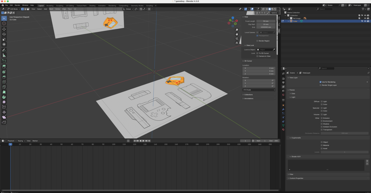

        Can you show us a Screenshot of your complete UI, when in Solid Shading Mode, please?
        #91298
          Yes, share screenshots and more context on the situation please. Right now is too broad and difficult to know exactly what might be going on.

              Yatkong Lai
                #91302
                  Up to the left it says “User Perspective (Clipped)”. You must have hit ALT + B at some point and you clipped the view. Just hit ALT + B again with your mouse in the viewport and it’ll go away.

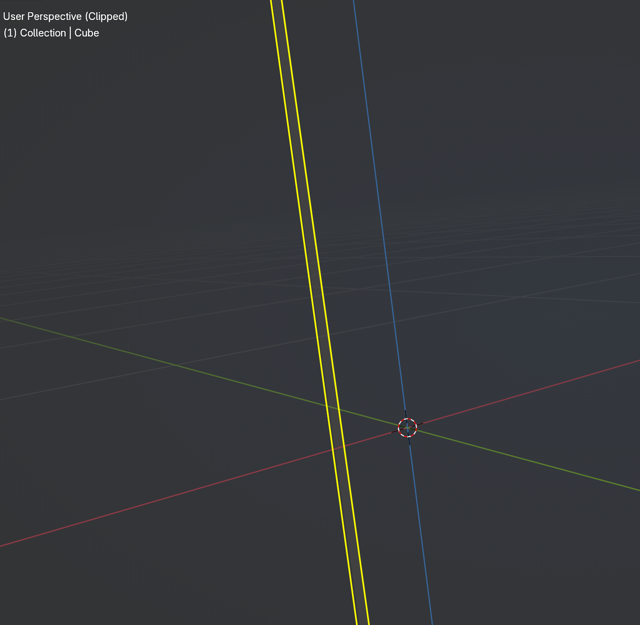

                      #91305
                        You can only see what is between the yellow lines in your file:
