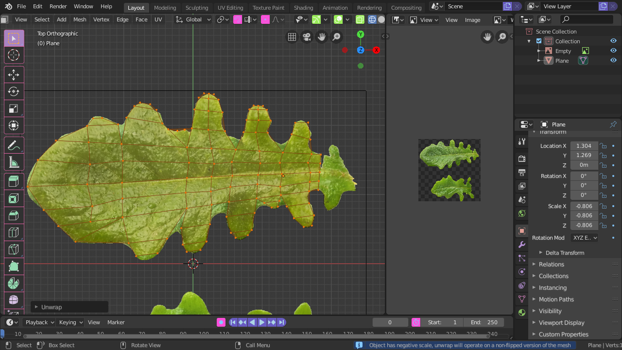

    shan jay
      I click unwrap but i says it has a negative scale

        It still unwraps, but it will give a mirrored UV-unwrap.
        In Object Mode press CTRL+A > Apply Scale. Then you can unwrap without any warning message.

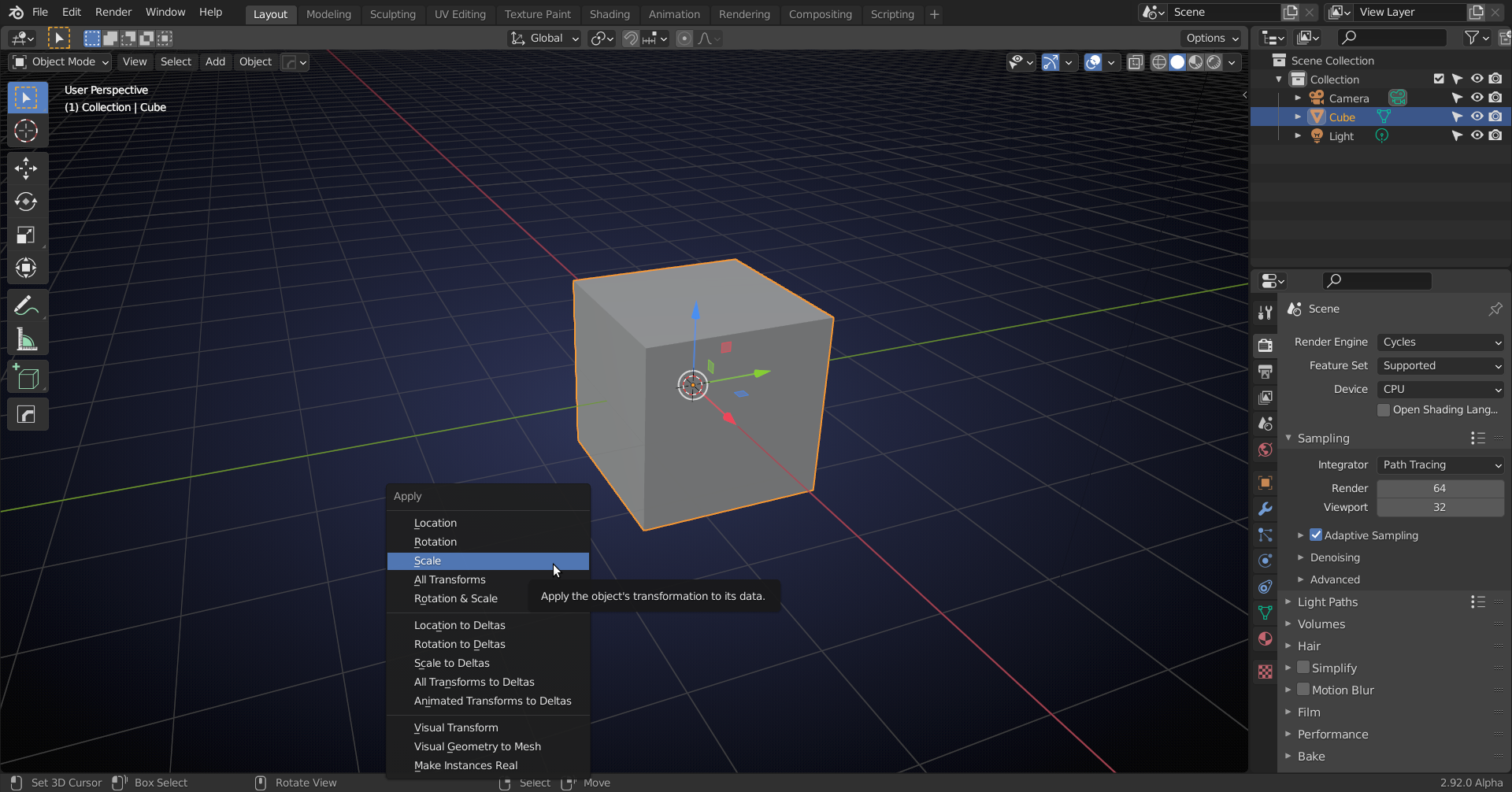

                      #61412
                        Press CTRL+A in Object Mode with the mesh selected and then select Apply Scale:

                          #61414
                            When you have applied the scale, it doesn’t have a negative scale anymore!
                            Before:
                            After CTRL+A > Apply Scale:

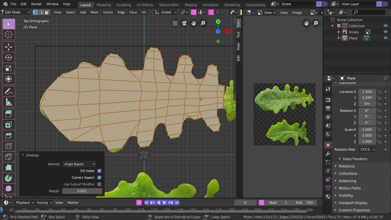

                            shan jay
                              yes the message is not there but it doesn’t unwrap it shows that it has been unwrapped  but on the uv editor there is no sign of it being unwrapped. what is this error?
                              #61416
                                In your screenshot you have the Image Editor open that won’t show the UV’s.  Try the UV Editor. (You can simply switch to the UV Editing Workspace.)
