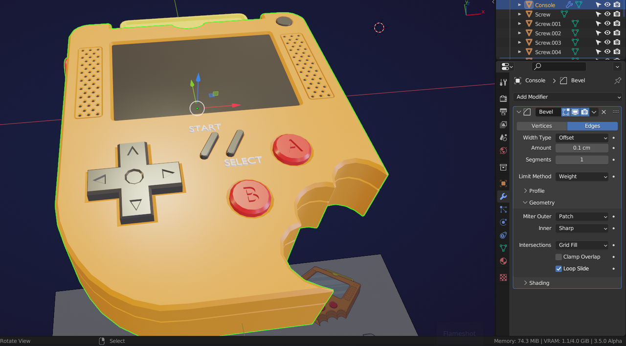

I apply the boolean modifier, and all the bevels are gone

      Hello! As the title says, when I apply the boolean modifier for the A and B buttons, for some reason all the bevels are gone from the console. The bevel modifier is still in the modifier properties tab, and it’s set to be visible in Object/ Edit/ Render mode, and yet no bevels are shown.
      Here’s the file, if needed: Console.blend

        Hi Muzan, your console looks great and you haven’t done anything wrong!
        It’s a 3.4 bug.
        Use 3.3 or 3.5 and everything’s fine:

          I see, I will grab the 3.3 version and continue on, thank you for letting me know!

            You can also set the solver to Fast instead of Exact – that seems to fix the issue as well and works fine in this case.

                “You can also set the solver to Fast instead of Exact – that seems to fix the issue as well and works fine in this case.”
                This was what worked for me!
                If anyone else is having this problem, look in the boolean modifier, you will see two choices to highlight. Choose fast, then apply the modifier and it will work!
