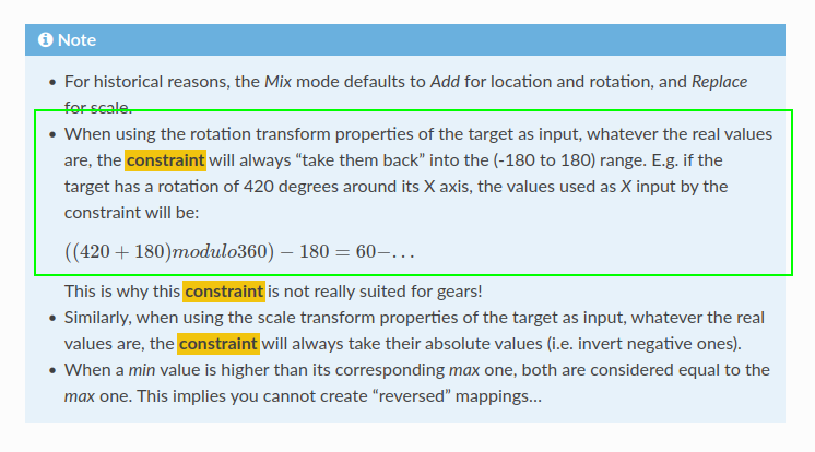

        Hi @GB ,
        Your english is great!
        This is actually a limitation of this Constraint in Blender:
        #76682
        Gaurav Badgujar
          So is there any other way than drivers. Or drivers are the only option we have.
          #76683
            I don’t know if there are other ways, but personally, I’d use Drivers for this.
            I’m sure Wayne will be able to give you more detailed and better information, after the weekend.
